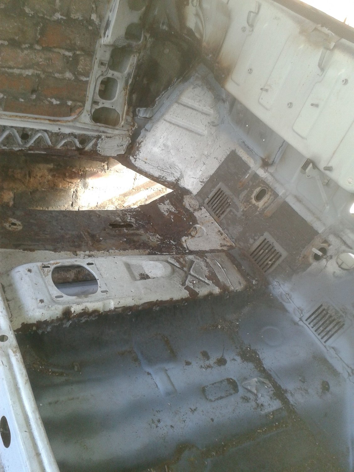

I bought this shell last week and just about ever panel is rusty.there is nothing on the shell at all so am after some advice is it worth restorin or not

Get it restored m8. Be worth it in the end. They are only going 1 way in value. I MIGHT be able to put you in touch with someone selling all the bits to put it back together and all NOS parts aswell
iTrader: (10)
Not worth restoring.
By the time you find ALL the bits you are missing it will cost more than a tidy s1 and at the end you will have a patched up s1 that's not a matching numbers car.
I broke a s1 last year and bonus balled another,yes they are valuable but the folk looking for the valuable cars are wanting nice shells,matching numbers,tidy interiors.
A good dash is £450 up to £1000,a rough set of seats is £500 plus,factor in a kit,welding,respray,loom,gearbox,bronze glass,sunroof,wheels,arb etc and it will bankrupt you.
If you can find a worse s1 that's complete it's worth doing maybe but even a rough 1 is 5k upwards,going by eBay anyway.
If you have the v5,floor number and vin tag sell it on is my advice,prob worth £600 as it is plus your lhd shell.
Thanks for comments am now gunna get rid I think.i thought it was prob not worth doing but I think I can save them all lol.am already working an orion,xr3i,2 sieres 2s and a xr4i turbo technics so think av got enough to do lol
