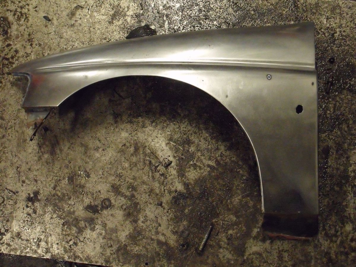

Posted these before but this was another job, bought 2 cosie wings and once I decided that I was going wrc with them they needed shaping too wrc spec, never done any panel beating before but came out alright after a day with a couple of hammers and a bag of sand
How it started....
How it finished....
How it started....
How it finished....

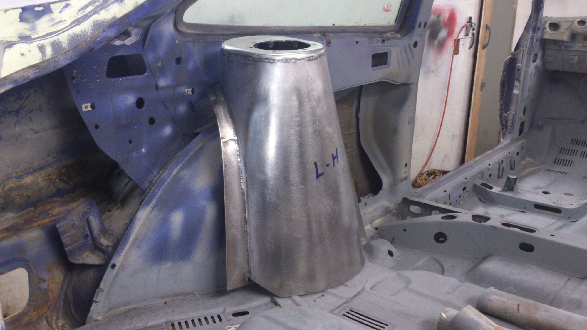

Hi Mate just looking at the thread again and on your front wings that you made a good job of putting the bubble in are you going fully widetrack this is because i see some guys have wrc wings on standard cars but they are not full wide track i have a set here off a white car that has the bubble rolled in it but are not any wider than a standard wing due to it not been cut where the sidelight sits this area is widen by 30mm giving the wing a wider track pics below one from the wrc book i have in a3 i have mark for you to see the item added in and then my wing with the added steel piece welded in
Thanks David only just spotted this but I had spotted that you'd had this done to yours so yes I will be going wide, its the only way isn't it? lol cars looking great by the way.
Maybe not a good time to mention this, I'm not picking holes but you fitted the front turret extentions the wrong way round they need twisting 180deg.....like this
In your first image you had them the right way round, but you welded them in the wrong way round.
Yeah I noticed it after I did it, did set them up the other way as you spotted and I'm sure there's a reason but nothing is jumping out at me as the top mounts look fairly symmetrical plus with the depth of weld that's where they'll be staying I'm afraid.
The top mounts only fit one way so you will be totally out ie 180deg out.... You will have to have either custom top mounts made or rotate the turrets as I said. It's not as easy as being symmetrical. I'm not as said trying to pick holes but you WILL have problems down the road when fitting stuff it'll all be backwards. Your best rectifying now than messing about later on trying to get custom plates..
Because the 2 holes are closer it only fits that one way and there are 2 types of top plates so if you fit them you'll be anywhere from 1-2" out...
Simpler just drilling new holes and welding the old ones up to be honest, the nuts are only tacked on, in fairness I might not of noticed so more than happy for people to say something along the way. hopefully more updates soon once I get the cage ordered.
