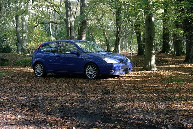

Well I thought I would make a start and post up my project thread.
My plans for the ST170 aren't that grand, I just want to get her "Foxxie" 100% right, and then I will look into performance modifications.
So firstly a little background on the car.
I bought the car through a garage near to where I live in Dorset on the 24/10/2012, and they had bought the car from Manheim Auctions. Foxxie has covered 117,000 and had 3 owners, the first was Ford Motor Company Ltd. Foxxie was built on the 13/06/2002 and was then registered on the 25/07/2002.
The paint is Capri Blue, and the interior is Waffle / Midnight Black. She is the series 15 fitted with a 2.0L Zetec VVT (170ps) engine.
When I bought the car I knew it came with a few faults, hense the bargin price but seeing as I work at a Ford dealership I thought I would bite the bullet and make a start.
The list of faults with the car are:
2 x Front tyres low on tread,
Exhaust blowing at the front and back.
Oil leak,
Coolant leak,
Screen washer bottle leak,
CD's stuck in the player,
Dipstick housing corroded,
General lack of love...
