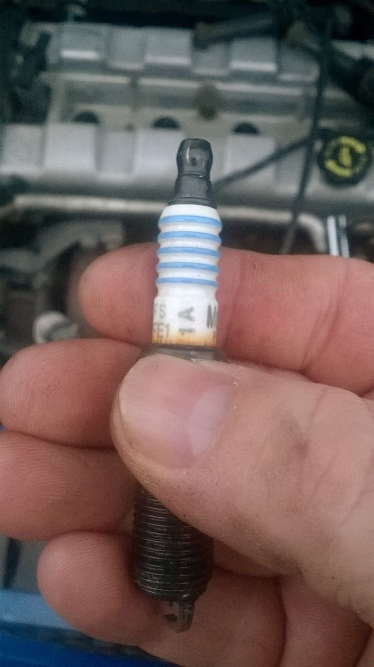

So the ST170 developed a little problem driving home the other night from work. Under heavy throttle use it hesitates throughout the rev range, so I will have it looked at tomorrow.

Well my car was looked at yesterday, and although I asked to have new spark plugs and a new fuel filter fitted, they recommended having the cam-belt done first, as the timing is out by a couple of thou which puts up the error code P1381. I can understand the logic in that, as advanced timing will burn out the plugs, but it's been like it for 4 years since they last did it. So nothing was done, and I said I would think about the cam-belt route over the weekend, and look at options on parts etc.
Sadly driving the 1 and a bit mile home the miss-fire got worse, and as I pulled onto my drive, the car had just cut to 3 cylinders.
So as it was still light, I quickly removed the plugs to take a look, and get the number off them.
The first plug, on the left of the engine as you face it, was very oily and the ceramic part freely roated.
No plugs.
I don't think the fact that the ceramic rotates around is a good sign lol, so fingers crossed on just needing some new plugs, maybe a coil pack. Sad bit is, where I work is closed today, and the next nearest parts place is nearly 30 miles away. So I will either wait until Monday or try and get the girlfriend to take me over tomorrow.
No plugs.

That sounds like spark plug 'blow out'. Usually means the plug was incorrectly torqued. If it had of been ejected it probably would have stripped all the threads, so luckily that didn't happen.
There's plenty reading on the web about it and the causes for it to happen. There is a mention of ignition timing also, so maybe get that checked out too.

I did pop over to my local Euro Car Parts and bought a set of plugs, as I needed the car first thing tomorrow morning.
Not my preferred choice, but at Ł28 they will do until I can get my hands on some Ford ones, and at least I can use my car tomorrow.
I fitted the plugs, and once I had gotten the HT - Leads seated correctly, the car started and ran fine. I let the car warm up, and took it out for a quick 5 miles trip, and both flat spots I've had for years had gone, and also all the hesitations had gone as well. The car still feels slow though, but it is an ST170 lol.
These are the old plugs.
It's hard to see, but the plugs are laid out in the same order they came out, and although the picture doesn't really show it, I swear to the naked eye the one on the left has a bigger gap than the others ?
