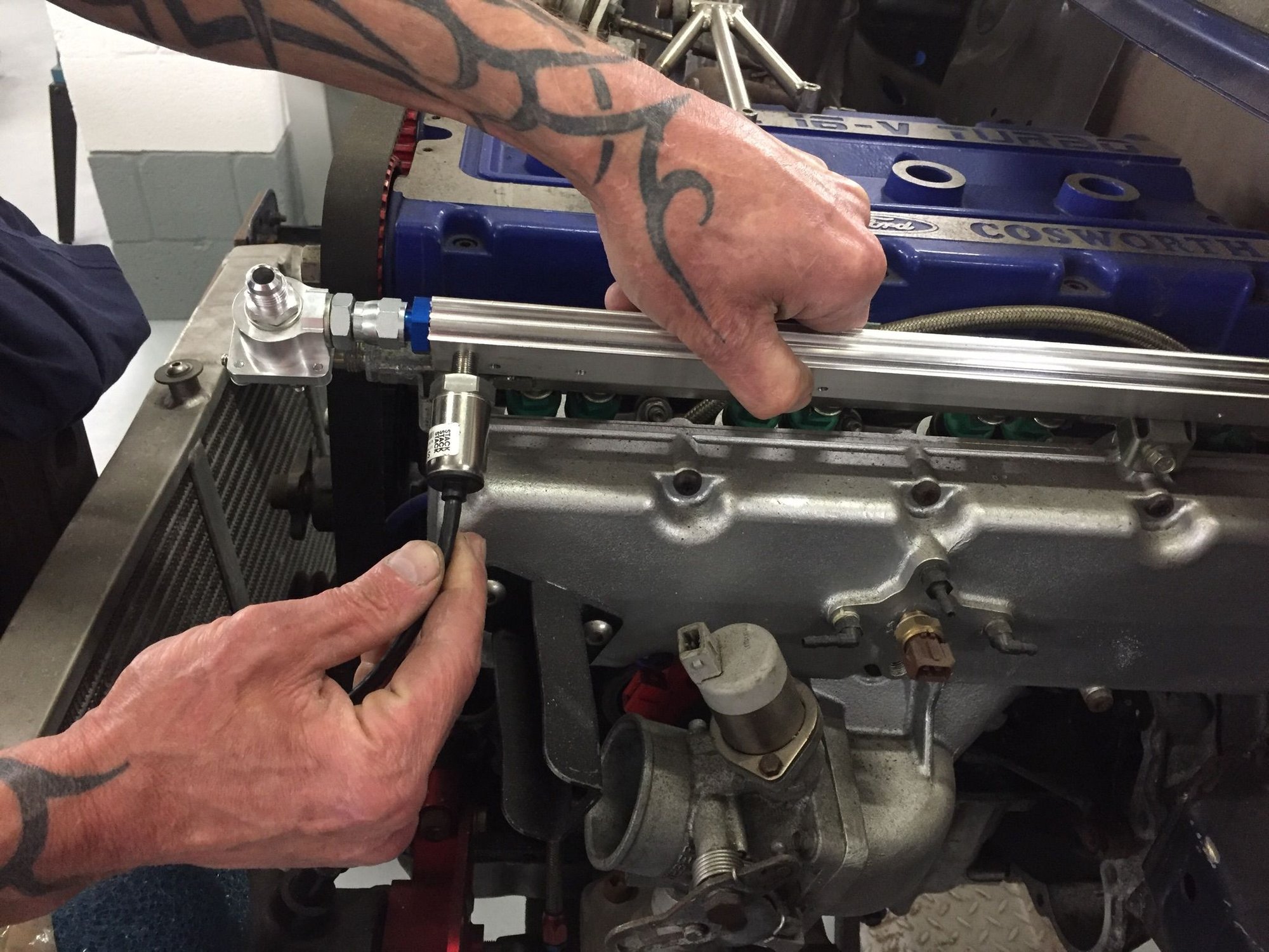

Mark Walker is doing a good job of lots of update pics on my fuel rail, cam trigger and a few other bits, car is off the road waiting.
Got my TT roadster to play with.
Fuel rail pic to show where stack fuel pressure sender will go. This will be black with Cosworth in red. This is Marks engine, not mine.

Fuel rail will be back next week with a few other neat bits, then I can finish the fuel lines and get driving again.

New fuel rail ready to ship to me, Mark MK is teasing me with the WRC breathers I think. He is also shipping me a blank for the dizzy and my cam cover machined for a cam position sensor.

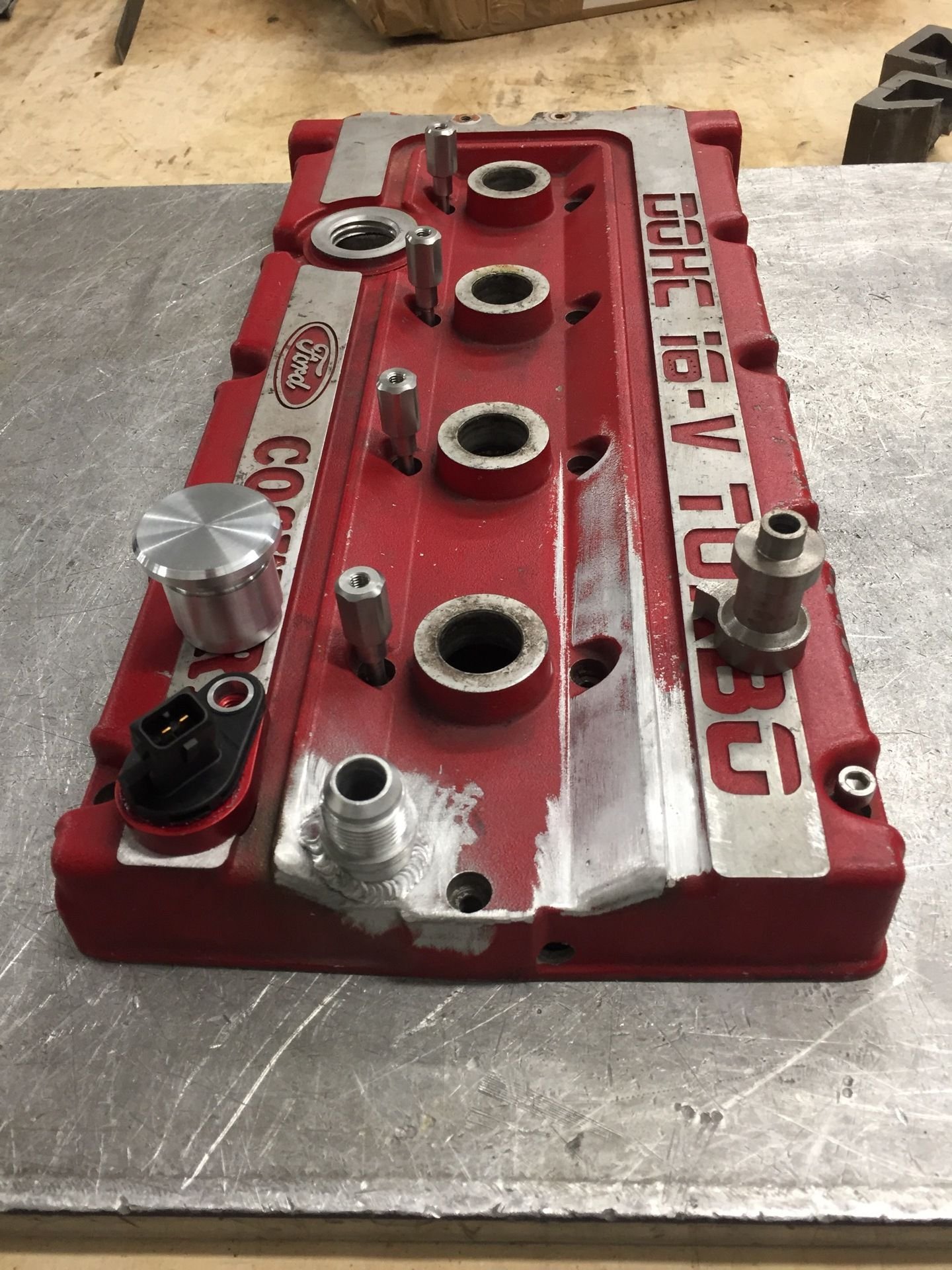

Mark has made these proper upstands for my coils, this is my spare rocker cover, will<br/>Send to spray station to be done in red
These screw in to head and the coils bolt in to these.
Cam sensor and breather moved
Old 03-07-2017, 03:56 PM
  #1589
Cam position sensor, blanking plug to remove distributor. All done and super speedy

Honda K20 coils go straight in no mods, albeit i went for the little billet brackets to put in nicer position at Ł30
What coils are yours?

Think mine are Yaris, no mods just saves long bolts n spacers which many use

Nice update Toby. I'm going cop on mine, Yaris coils too. I might get Mark to do his thing on my cam cover
Old 03-07-2017, 07:42 PM
  #1593
Makes a nicer job, mine came loose when I just had spacers.

Yeah make sure you get the correct Yaris coils if you use them as some are too short to reach the plug cap
The short ones in your pic will not reach the plug if your not milling down the cam cover turrets!
Also I don't recommend using any pattern part coils only genuine
