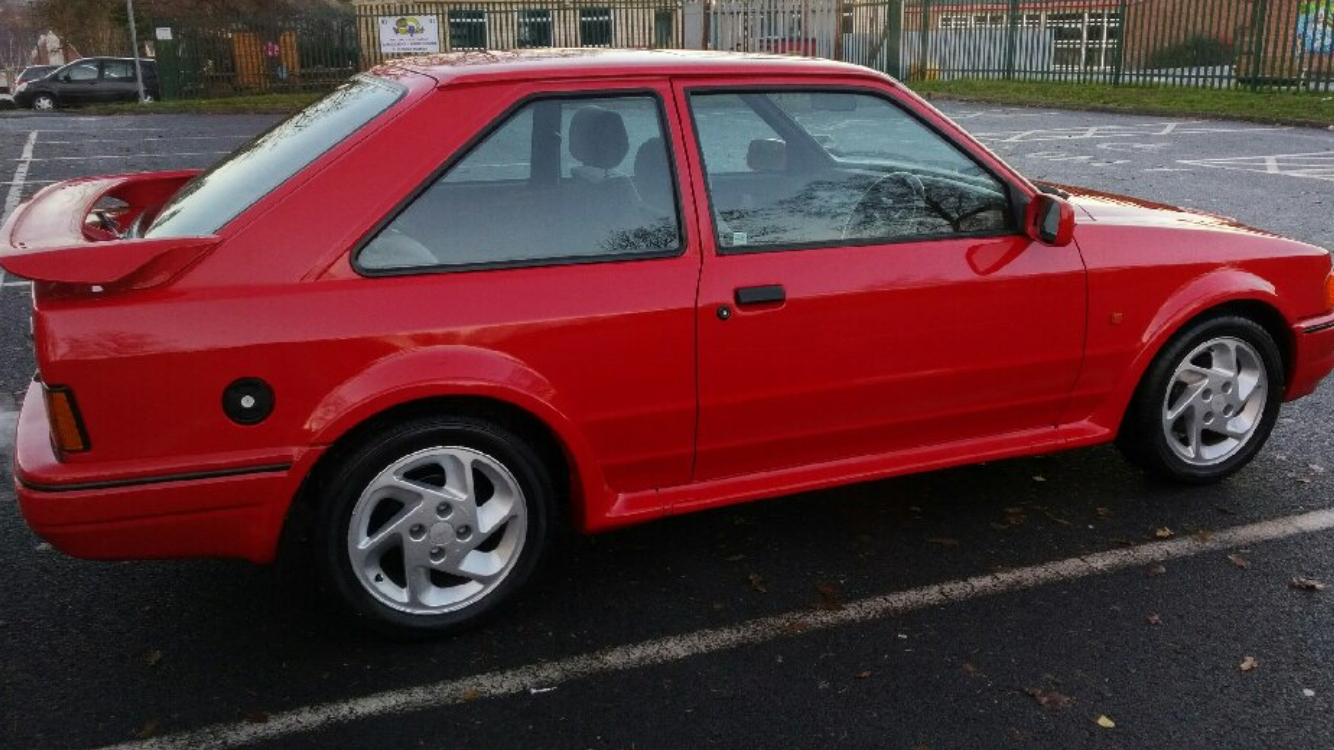

Looked like a tidy car
Bought me an Escort rs turbo this time last year , looked like a real tidy car , planned to give it a quick respray in time for the summer... NOW BALLS DEEP IN A TOTAL RESTORATION. Starting to lose the will , thought I might share some of the journey with The Ford community for a bit of an offload . First time on trying to learn how to upload pics?

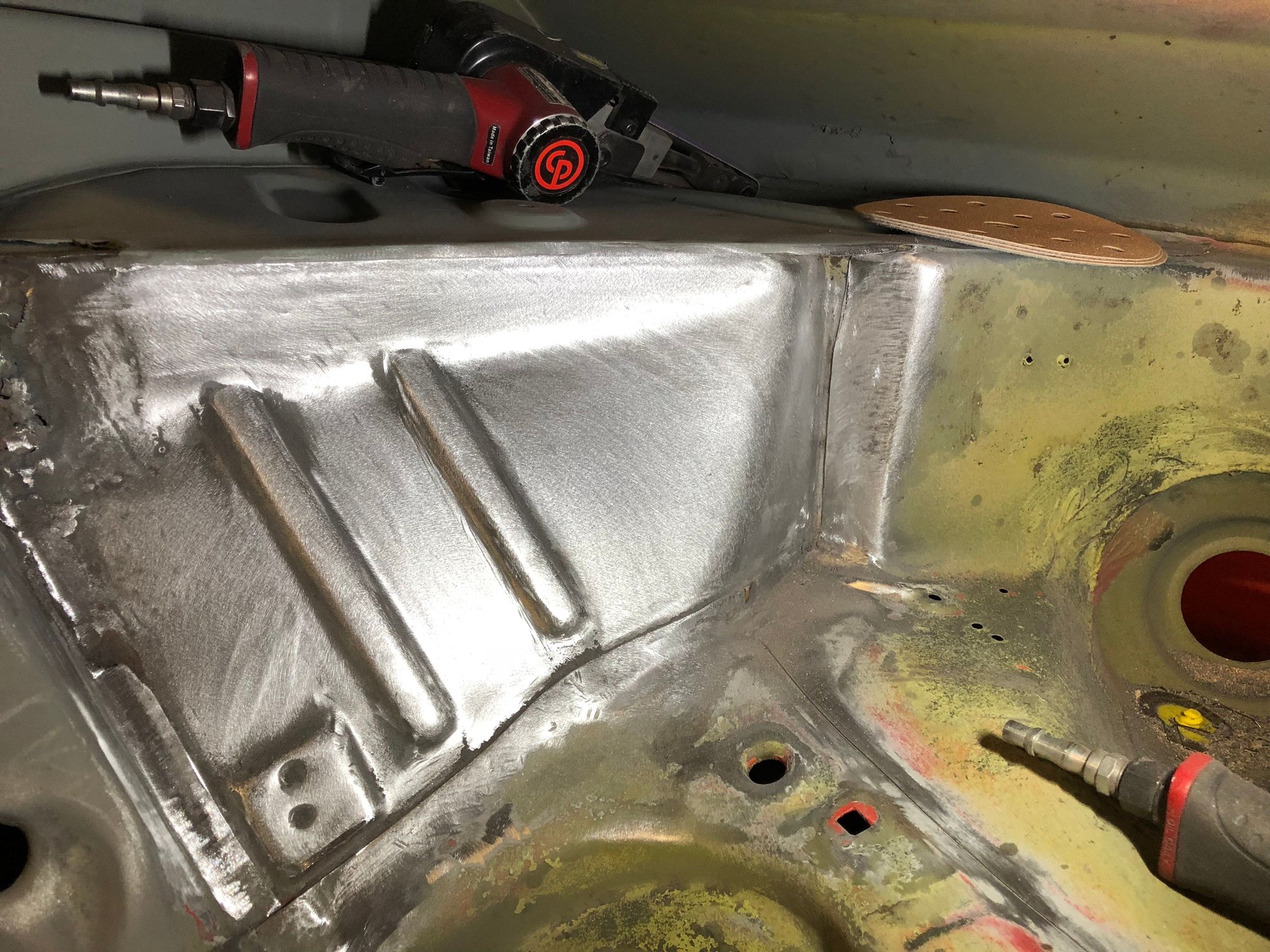

Once all the suspension and running gear was finished wrapped up and stored I stripped all the plastics to bare fixed any imperfections and primed them up
Just literally sanded the paint and undercoat off with a Festo and p180 disc , laborious but does a good job

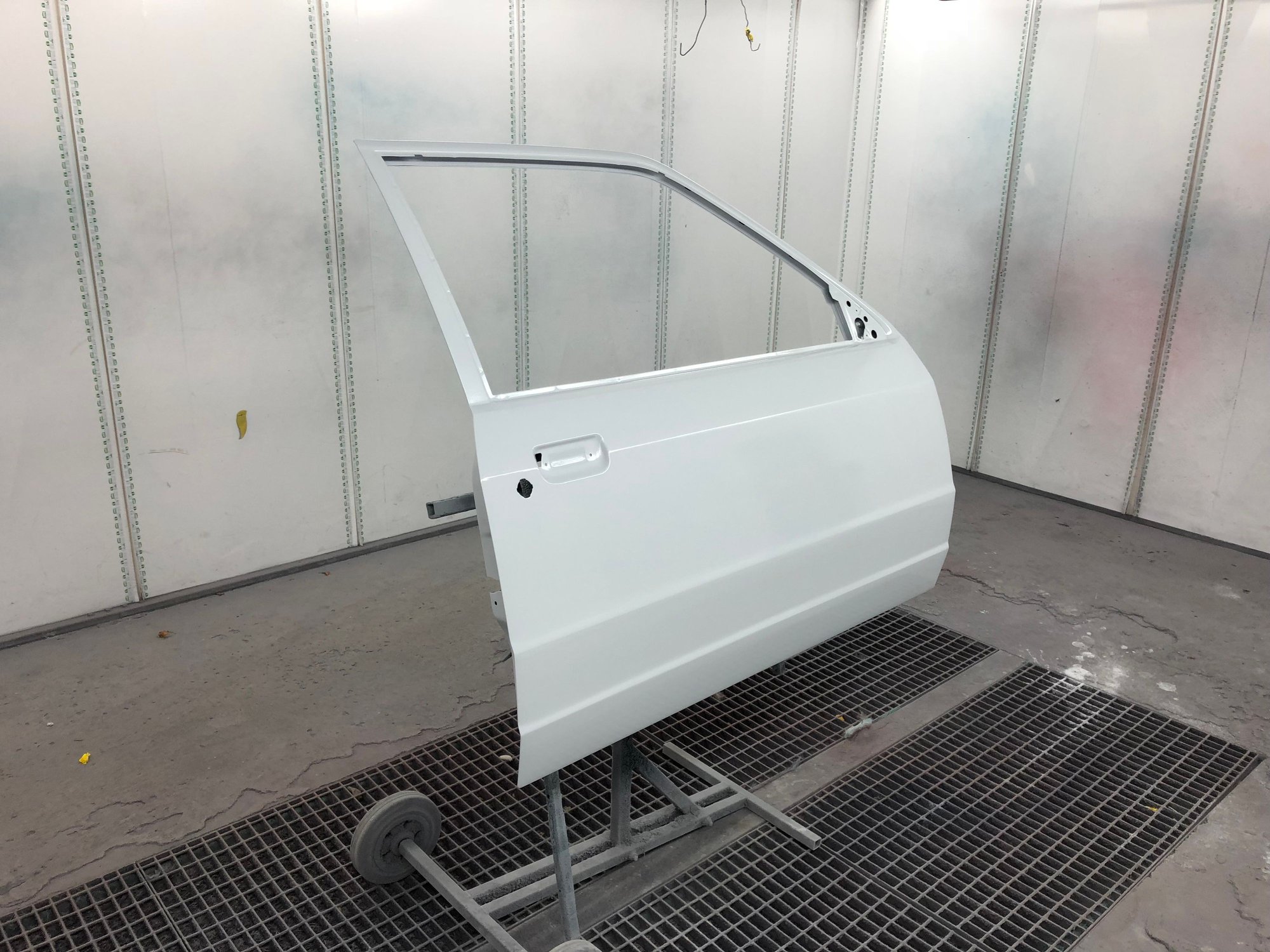

The door you see in this image was scrapped , it was the original drivers door but it was rotting in the upper from the mirror corner across to the middle of the door .We cut out the section and welded in a metal strengthener that we made welded the repair piece in and repaired the door but after I primed it we just were not happy wit it it was swelly looking slightly bowed , so I set about looking for new doors
We set small sections of new metal in to patch the tailgate.
Each panel was primed and cured for around about 8 weeks the blocked and reprimed a second time to ensure perfection
Plastics all in primer I turned to the panels , we scrapped both the original doors, although the drivers wasn’t the worst , it still was always going to go tits up again a few years down the line so we had the bonnet and the tailgate to get on with . Tailgate had minor rust at the point where the spoiler bolts on , easy peasy, and the bonnet was rust free but had a couple of dents to repair . I stripped both panels to bare metal and did the repairs and anti corrosion and high build primed both panels.
One new one second hand
Each panel was cured and blocked down and re primed just to be sure it’s perfect
I know a guy in Antrim has a fair eBay shop selling only genuine Nos ford parts , almost anything you need he seems to have it , goes by the seller name Clomoco, I gave him a shout and bought two doors, one brand new old stock drivers door and one second hand passenger door. The second hand door was better than the new door! It was completely rust free , stone mint! The new door was in that black factory primer and it was failing in spots here and there but little buns to fix , both panels were completely stripped to metal anti corrosion primed and high build primed,

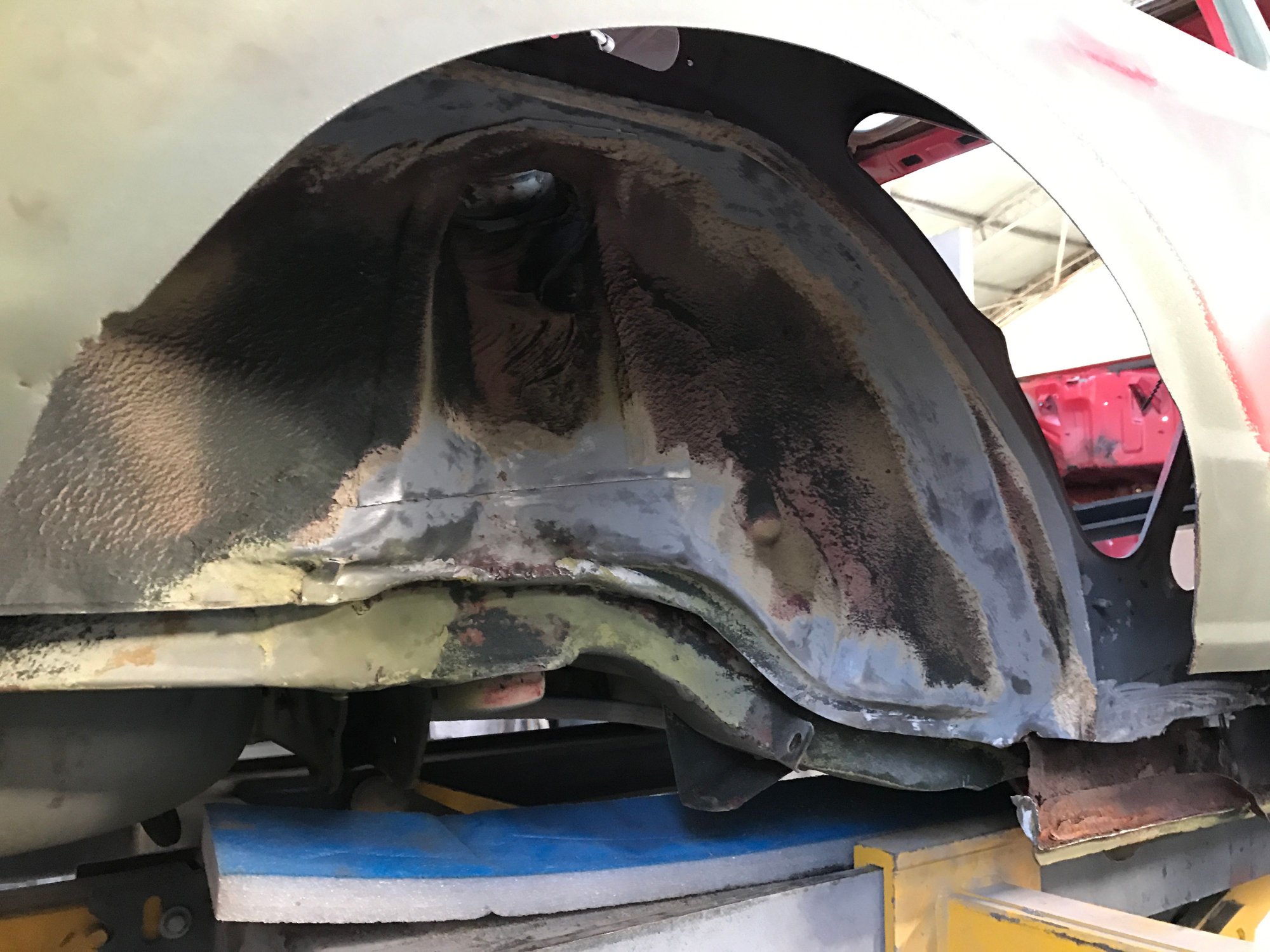

Added these images again, just to highlight what it looked like , I mean it needs floors ,sills ,inner and outer arches , 2 Chassis legs , rear inner 1/4s front panel and cross member . SERIOUSLY
Some bollox had covered all the trouble with crappy patches , isopon and under Shultz, it was just MOTd paint job was average but ok , Engine went well it is fast. sounded ok , so I bought it . I’m not sure you can get much better for 5k but I’ve definitely spent more than that again since and the car isn’t painted lol

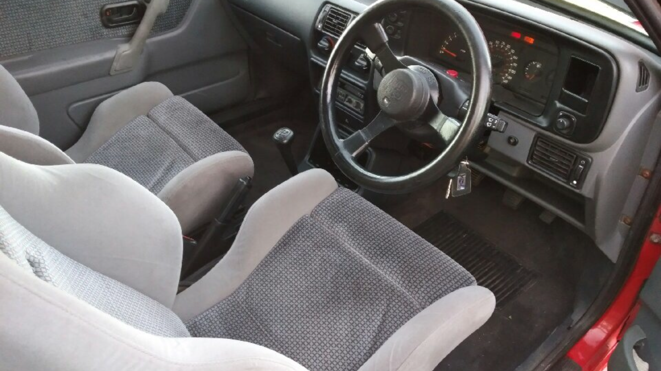

Must say the interior is magnificent , one real big plus, but I’m still going to repaint the backs of the rear seats , I did them on my fiesta , it takes years of the car , you know when you open the boot and the backs of the seats are tired and marky, lift them out quick sand mask off the material and paint 2k satin 25 / 30% gloss , makes them just class
The screen and some deft sealer work hid this problem
We just had a night where we cut the shit out, front panel and wigs are great so I decided to keep them in , I bought a new front pane and x member, but we only fitted from the headlights down . I’ll show a pic of that job later
Inner and outer arches cut off
Sills cut off
Inner silk out
We cut about an inch off the floor and got a folded length of steel right angle the full length to make a new floor outer edge, recommended for spot welding outer sill back on
This is the inner sill being tried in , the new floor edge is fitted , see how the new inner sill sits on it , when the outer sill goes on the two lips are clamped and spot welded, like factory. It’s the only way to do sills, any metal shop will fold two lengths for a few quid
