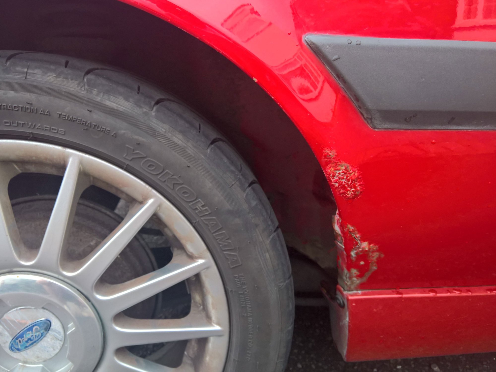

I'm hoping to get this wheel arch tidied up on my fiesta mk5, is it bad enough to warrant replacing the whole arch? Admittedly is does look slightly worse in reality than in the pics, How much roughly will something like this cost? The car isn't really worth much so i don't really want to spend a vast amount. Ive been doing bits an pieces to it myself to tidy it up since I've bought it but wouldn't attempt any type of body work.
I'm struggling to find somebody to do it, the only place that was recommended to me aren't interested but that's another story.
All wants cutting out... tidy up won’t last 5 mins

Problem is that to do it properly on one of those, you need to put a 1/4 panel on as an arch will never sit right and will need loads of filler to hide the rippling effect from all the welding as.the metal is so thin on those cars. Also means that you can find any other hidden rust, which there will be.
Bodywork repairs can be and usually are more expensive than mechanical repairs on a lot of cars and to fix the rust problems properly on your Fiesta will cost as much as you paid for it. Always a difficult choice on a car which was cheap to buy. It depends on how much you like your car and how long you intend to keep it. If the rest of the car is in really good condition and you can afford it I would get it done and that way you will have nothing to worry about long term.

The thing with rust is that it's starts off ok then as soon as you start to remove 8t holes appear. You could try kurust but I think it will just come back.
to me the bottom of the arch looks the worst and I bet this ends up being a hole.

4 body work shops I've been in contact with now and nobody wants to do it, 3 haven't even seen it. They just say call back later but then never answer/ or say they will come to me but never turn up. The only 1 that has seen it said he can have an easier life and make more money just respraying. so wasn't really interested.

This is the problem when you have paid less than Ł500 for a car and to fix the rust properly will be at least the same amount. It really depends if the rest of the car is in excellent condition and you can afford it it could be worth the cost, but if the rust is only one of the problems then probably not. This is why breakers yards have loads of fairly modern cars in them as many have failed MOTs with rust problems and the cost of fixing it is often more than the value of the cars.
its quite a sound car, never been welded or had any advisories for rust.
I agree totally with what your saying, the only place that actually looked at it said it would be about Ł350 worth of work, but said he could make that easier doing paint work so didn't want to do it unless i got the metal work done somewhere else and he just tidied it up and Painted. Nobody I've approached even wanted to do the metal work.

I wonder if a place that does Welding for MOTs might be interested? They are well used to having to make metal repair patches ,cills etc. Sounds like the places you tried are only interested in making quick money and don't want to have to earn their money by doing any actual fiddly time consuming work!!

Good news, the guy came out and had a look for me. Said it is not bad enough to warrant a entire new arch. He will cut out the rust and fabricate a piece to put in the bottom and same again for top of arch. Ł200-300 was what he said.
he had a good look underneath, had the side skirt off and looked all round the car and said he was amazed at how tidy it was which was good.

Picked it up tonight, all done. I'm very happy with it, when i picked it up the guy who did it showed me he had done some other bits that he noticed needed tidying up and at no extra cost!

Wow what a good job. Rust looks nothing till you start pokeing at it Then holes appear.
I would be removing the inner interior panels and get some wax oil squirted in the rear quarters.
