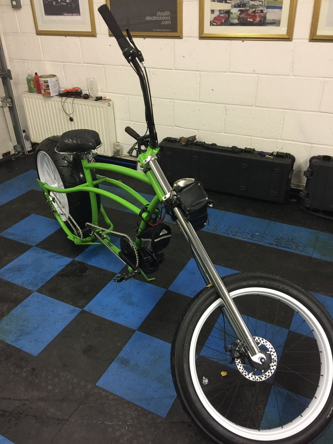

It does work, YES. I found the best product to be SLIME, it comes with an air pump to put it in. When I built my e-chopper I used it to seal the rear rim as I could not get the spokes to hold air no matter what I did, one bottle of that and the tyre has not needed any air in 6 months.
This is the home made back wheel made from a van wheel that I cut and spoked and used slime to seal.
