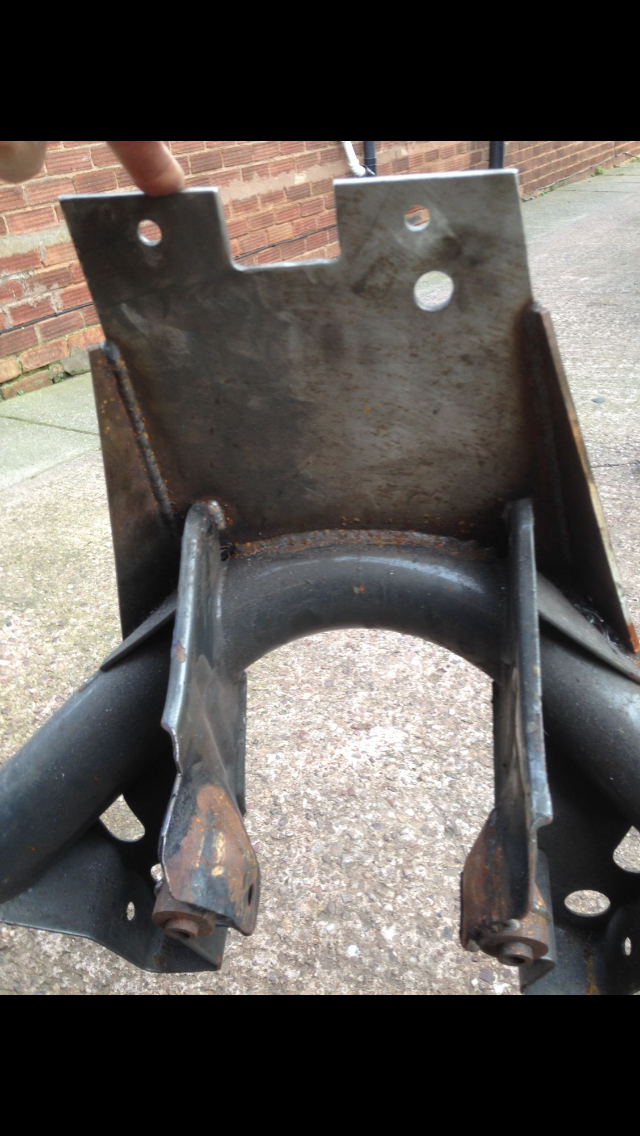

This is wot I did to my beam to hold the supra diff
and iv never had a problem but I all so use MT rear cover

That looks good that's what I want to do to mine,do u modify beams for other people? or does mk do it?

Here is how mine is done by MK motorsport
This can take supra and normal diff

Very nice, do you still need to use the alloy side brackets from the mk kit or is the beam modified to bolt on the sides too?
Old 18-08-2017, 09:10 AM
You do not need any fitting kit at all, the beam is modified to use the side bolts. It is SO much easier to fit too, the fitting kit did take me a while and a bit of juggling about but with this version it was minutes to fit.
I still use the MK billet diff holder to support the MK cover...sometimes I think I need to re-register the car as an MK and no longer a Pug.

For what it's worth I have a weir kit fitted to my supra diff and it's mounted in a kit on a standard rear beam.
I had 530hp and the car was used in anger (2wd) and saw some drag action too.
I split the original cover almost straight away but the MT billet cover I have has been faultless so far.
I will be upping the power another 150hp next year so we'll see how it handles that.
I will try slicks at the strip too next year.
I also have a spare supra diff with a different ratio in it incase I ever wanna swap
Cheers Paul
Great, thanks for that info il get in touch with mk then to get my beam modified to take the diff.
Old 18-08-2017, 12:05 PM
Worth getting him to add the lugs for a bladed anti roll bar just in case you ever want to run one.
