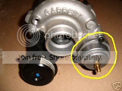

its only at Ł200 at the moment,the picture of the turbo on the housing
that goes to the intercooler theres sumthing that looks like a valve
hav u any idea what this is for
standard re-circ dump valve maybee

thats the one t28 rst,says its brand new,thats the valve i was on about aswell

yep, thats a standard re circ dump valve, the T25's have them aswell I think, like on the rover turbos.

would i hav to just blank that off then or run the pipe to the inlet
manifold
Old Feb 23, 2005 | 10:00 AM
220TC's Avatar
220TC
Posts: 956
Im not quite sure whether it would work if you connected it up, cant think of any reasons why it wouldnt
You can blank it off, either buy a spacer to replace the spring in there or get a plate made up and take it totally off, its up to you. If you have a dump valve installed elsewhere in the system then you will deffinately need to blank it off.

Mine is just blanked off

ive got a dump valve on my car at the moment but when i get my
estate the dump valve will be coming off so i will just blank it off
