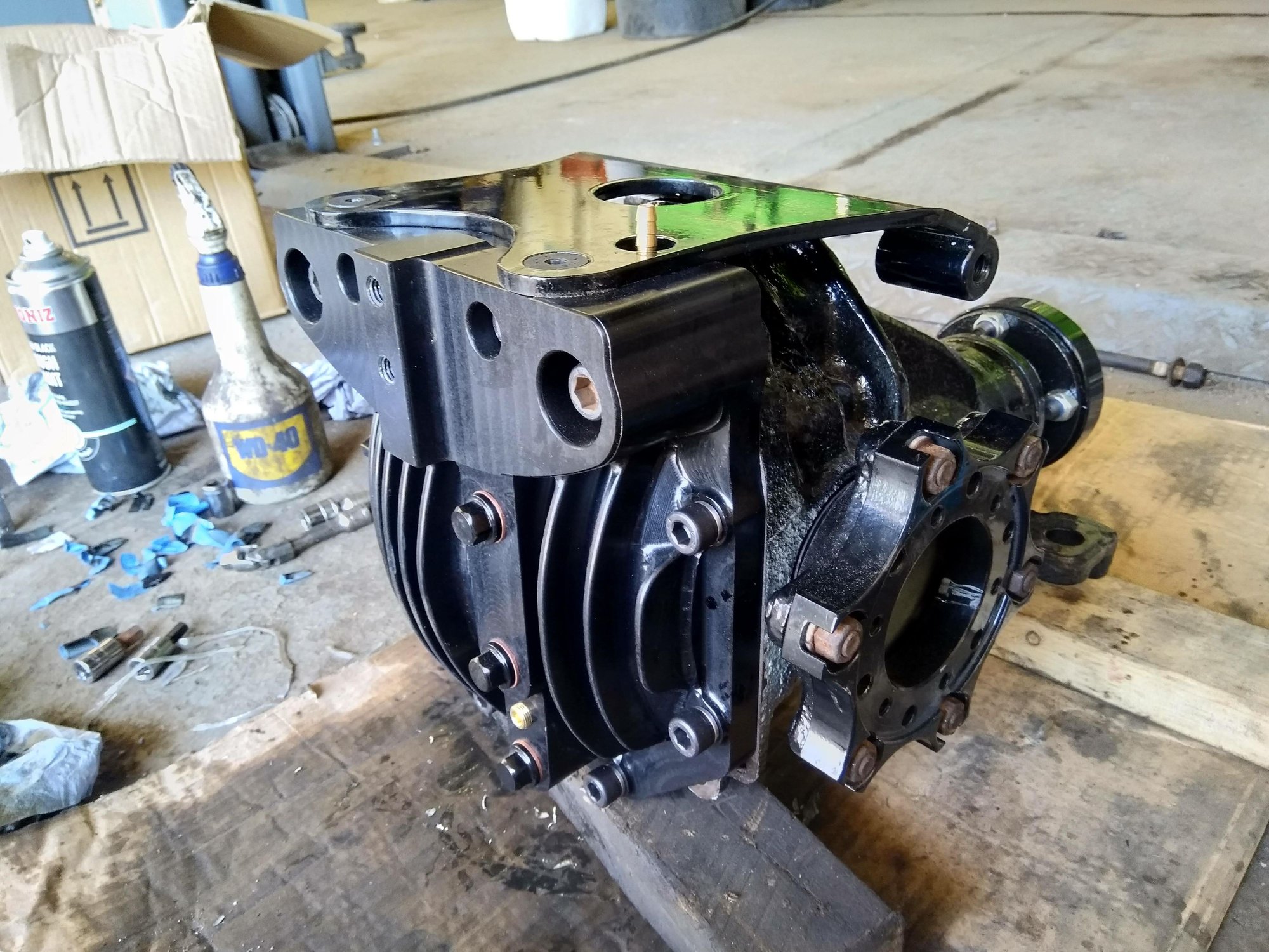

3.9 Supra Diff
Mk fitting kit
MT Motorsport cover
Adrenaline & OMP rear strut braces
Adrenaline brace bolts through the floor and into the diff hanger.
Im not a mechanic but helped my mates do the work over at thier Garage. The Grease Monkey
More of a job than we anticipated with lots of fettling checking adjusting cutting finnessing as is often the way with modifying stuff.
The diff takes around 1.5ltr of oil and your looking at £15 a litre for a quality oil.
I need to get the exhaust modified a touch as sits to close and catches the propshaft at the nose of the diff, otherwise everything seems good and I am very pleased with the result and general fit and finish of the kit parts. More urgency in the power delivery with the 3.9 ratio. Will be testing fully in the coming months

Can anyone confirm if i have used the right diff oil?
Been looking on a couple of supra forums. Seems everyone has a different recommendation or preference.
Seemed to drive fine. Will see what its like after some stick and heat in it.
What are you guys using in yours?

Supra diff drain plug
Changed the oil to motul ls300 75/90w and that's sorted out the unbalanced handling characteristics it had before.
So chaps for reference definitely use a 75/90 ls oil in your Supra diffs.
I'm going to change it again after a few miles and hope the swarf is minimal.

Its a bit of a fiddle. I think one of the main things i hadnt really considered is the exhaust needs modifying to clear the diff properly.
We heated mine red hot, then with a suitable die squashed it in a large press to ovalise the pipe. Worked a treat to.
Don't cut any corners. If your using a fitting kit get a MT rear cover to ensure nothing breaks. I've found motul 75/90 ls300 diff oil pretty good and I've tried a couple now.
It has changed the handling characteristic of the car a little. Bit less stability on the rear when pushing on. Could just be my diff though. Got mine off ebay and it could possibly do with a refresh at some point.
What ratio is yours? As others have found previously the 3.9 is a real sweet spot for fast road.
