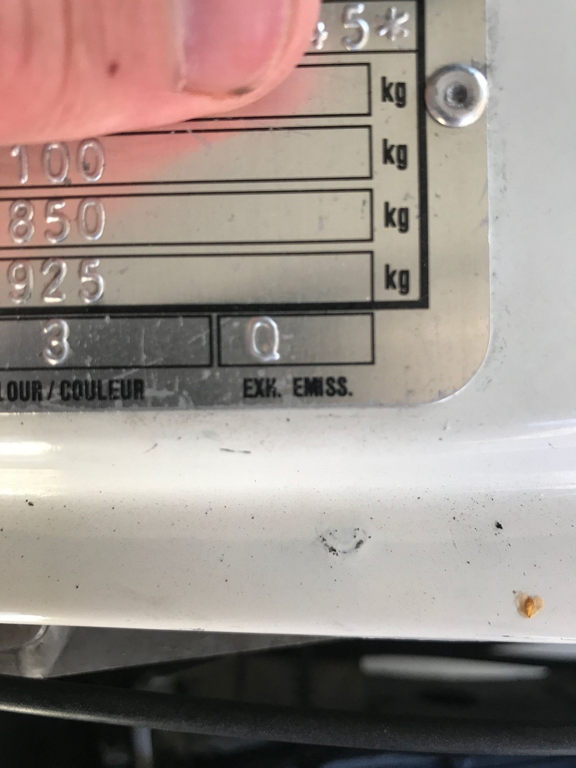

i read it’s 1/1/93 which means mine would need a cat and removal is instant failure whether it passes emissions or not my garage tells me.
does this help? Exh emiss Q
assume thats exhaust emmissions q on vin plate

i spoke with my garage and they didn’t seem too concerned to be honest, they looked on a data base and had no info on my car so said they could do a non cat emmision test
so think I’m ok!
