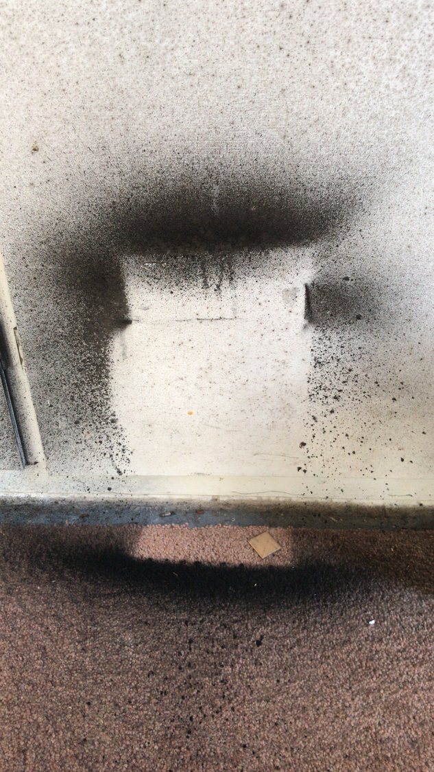

not sure what it’s actislly running but think it needs setting up as too rich This is where the exhaust sits in the garage
I’m starting an exhaust art business!!!!
