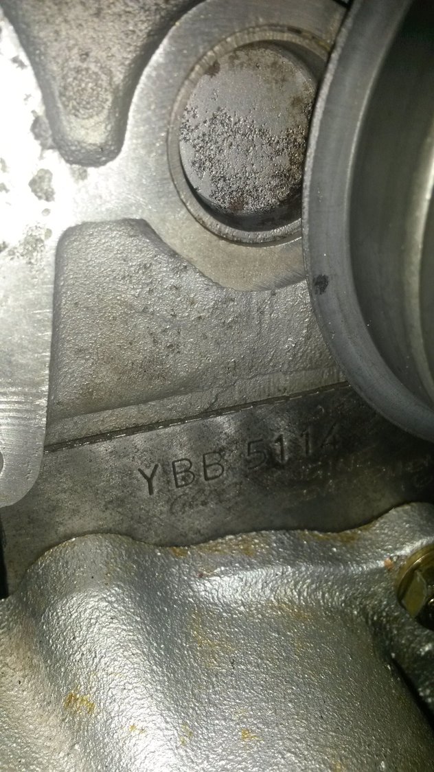

that doesn't look like an engine number. That's the number stamped on the front of the block isn't it?
The engine number is on the bottom right hand side of the block just behind the oil filter.

Presume the 'YBB' number is some sort of casting number, as above the engine number is underneath the turbo. Here's mine
