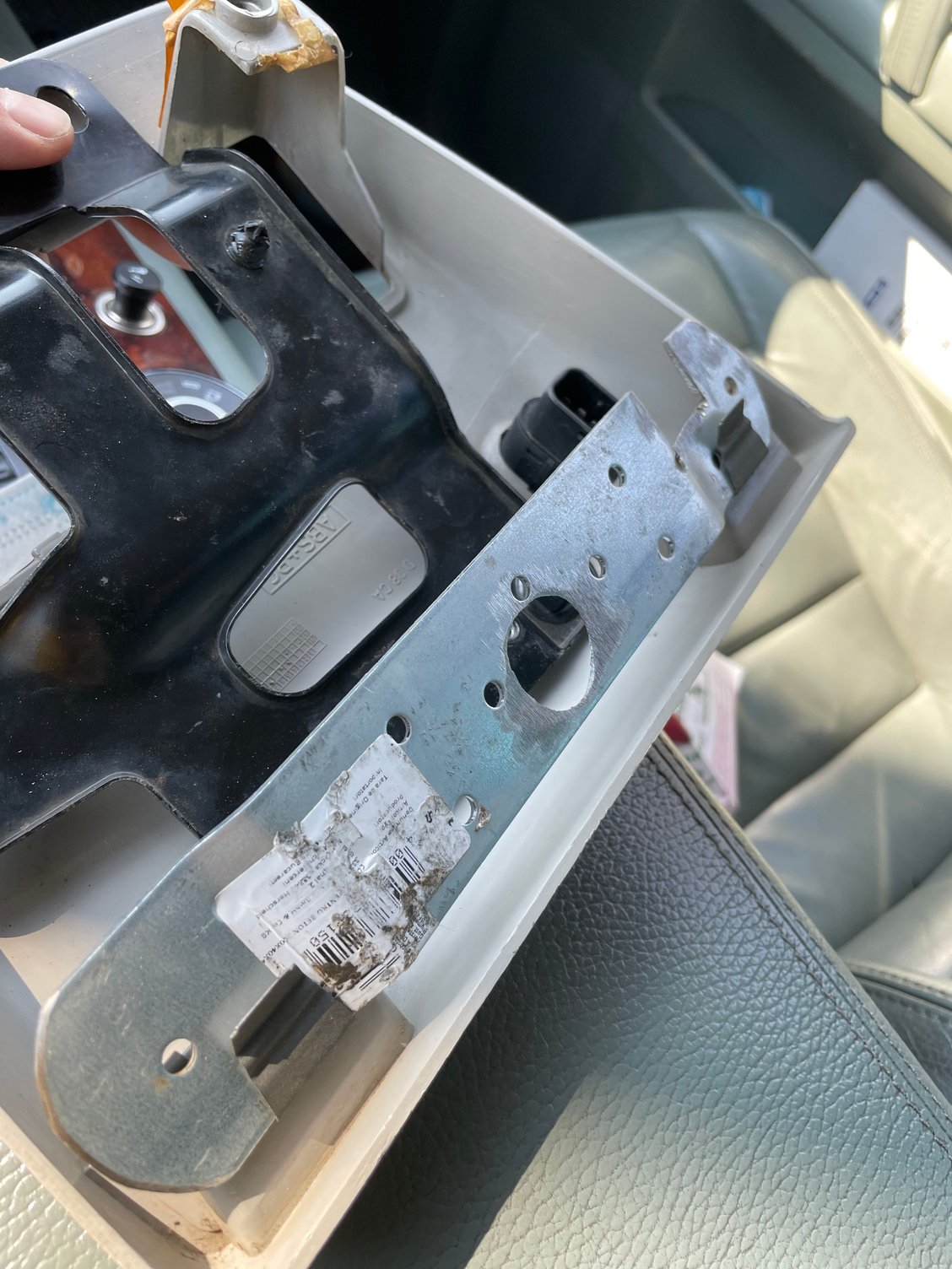

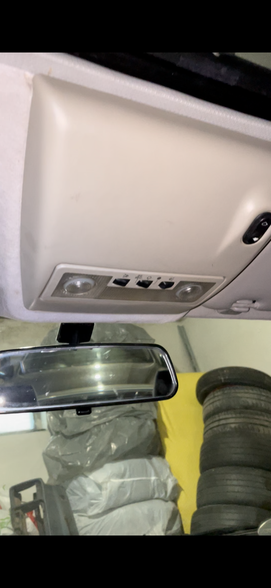

Yes, you will need to cut the roof a little to fit the motor. You will also need to make a bracket for the back of the cover. I got the switched live from the electric windows wire.

have you got any photos of yours fitted ?

This is the bracket i was talking about

Hmm interesting i didn't know you also needed a additional bracket. I thought the cover just clips onto the main cradle, mind you I'm still mocking mine up for the conversion also? Mine was the windy windy type
