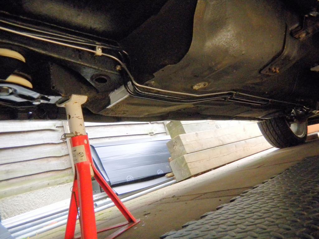

I got my tube from a company called ATEC in brackley, Northants but I had to change to graded hoses from the hard line at the pump & engine ends.
The hardline I got was an aluminium tube with a black polymer coating which is easy to form with a mini pipe bender.
Got some picks somewhere if you want them?

heres them picks, it might not be the look your going after but this is what I used, give these guys a call they were helpful with me when I done mine a while back.
