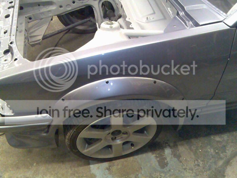

on mine (above) it was done for both looks and the fact that the arches have been trimmed right back to allow for clearance
so nothing there underneath to bolt it to original mounts

how do you make the recess in the arches though?

rs shawn
its being built for the track but im gonna stick a mot on it, god knows why it will be horrible on the road
boXXer
no reccess, just use ally rivets so that it wont pull in too much, also you need to watch how much of the arch you cut away
too much and it takes all the strength out of the arch, i did get a couple of patten wings to test on first, see where the limit was

Did you use black ally rivets then?
Old May 11, 2007 | 05:24 PM
gus's Avatar
gus
Posts: 10,507
From: essex
yes mate

where did ya get them from? and did you use a normal rivet gun?
Old May 11, 2007 | 06:03 PM
CozzyBrom's Avatar
CozzyBrom
Posts: 5,391
and dates back 40 yrs to the mini
Old May 11, 2007 | 06:04 PM
gus's Avatar
gus
Posts: 10,507
From: essex
a mate got them from fords for me, not sure what they are used on thou
yes normal rivet gun

Phil going to do my 3dr the same,did you just use black pop rivets,if so you got a close up pic of arches
cheeRS stu
Old May 11, 2007 | 06:08 PM
CozzyBrom's Avatar
CozzyBrom
Posts: 5,391
he may of used riv nuts and used threaded bolts,pan heads to bolt it on as rivits wud squash the arch panel to much only a guess

closest one i have
as said use ally rivets and they snap off before they pull the kit in

Thats what was worrying me brom,how the arches would squash if pop riveted

i think maybe do what brom said? Drill a hole, bolt through with some black pan head bolts and nyloc nuts would do the job.
Now on a mission to find some black ally rivets
