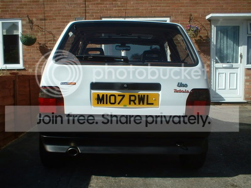

Picked this up cheap yesterday, yes number one because of the bonnet scoop (which doesn't look that bad) number two the log book states it 1 litre but with the 1372 engine, all registered with DVLA as having engine transplant, comes up on insurance sites as Uno Turbo everything has been switched over including the beam for the rear discs, can see where old brake lines were and new breather added to fuel tank as wasn't injection previously etc was a 1 litre shell originally not a turbo with new ID so not a genuine Uno turbo but everything on it and has Arbarth bits too and, get this, no rot! lol
Bloke just had the headgasket done, adjustable boost, titanium shims, piper fast road cam and iridium plugs
Number three for the cheapness was it smokes terribly on start up from cold and slightly under load, but seems to go when warmed up - the seals on turbo gone? Gasket looks to be new.
Anyone know what turbo they have, if anyone still does them or where could have it re-con'd? Failing that may just stick it on ebay as is

Cheers chap, sound like a turbo problem to you then? It is white smoke and the tailpipe is slightly 'oily' smoke under load and start up when cold suggests the oil is seeping through

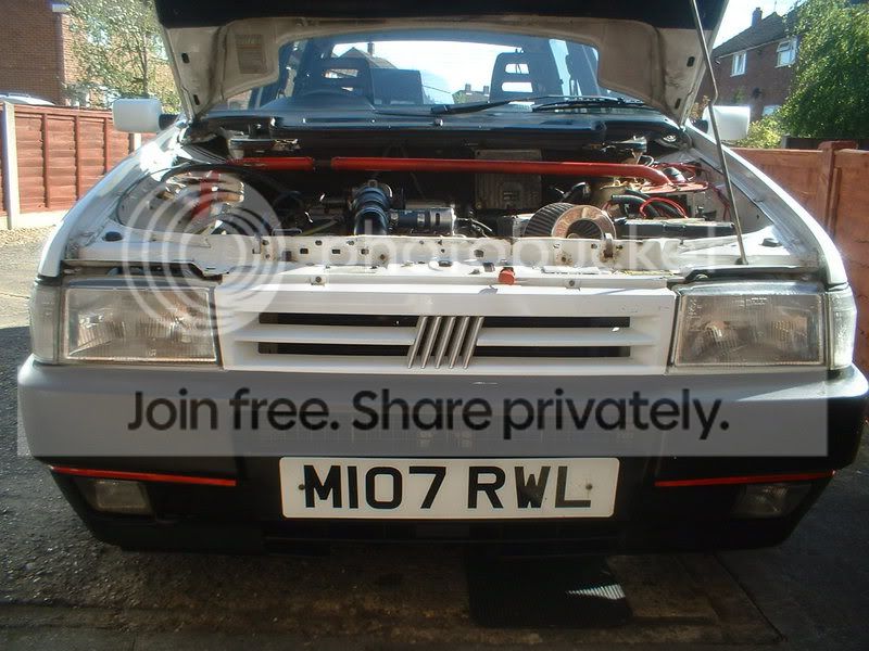

I fitted a rs cosworth t3 hybrid on mine you need to knock the bulk head back to make clearance and a adapter flange welded to your manifold and a down pipe for it to fit as I specialize in them if you get stuck you can pm me I personally think it could be seals in the head or valve guides plus the 1.4 suffer from pistons craking around the ring area I am currently rebuilding a engine for a customer with all forge internals had the same symptoms as you for the same car
Old Apr 29, 2007 | 08:29 PM
abdr500's Avatar
abdr500
Posts: 3,905
From: enfield

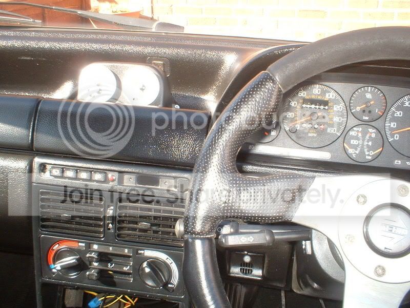

and just noticed you ecu is upside down put it upright m8

just started the uno no smoke ??? all the plugs are fine no oil on them. compression the same on each bore ... must be turbo oil seals...
for it to smoke one minute and not the next ??? jas

the best test test for a smkey turbo is give it a blast out on a private road so its nice and hot....
leave it to stand ticking over for a couple of minutes, then as you pull away check to see if theres smoke behind you
basically, the seal expands when hot, and allows oil to seap past if its goosed
carl
