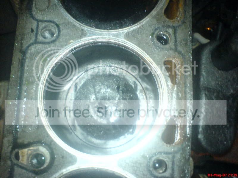

Old May 1, 2007 | 09:40 PM
BigErn's Avatar
BigErn
Joined: Nov 2006
Posts: 7,445
From: Sunderland
Pulled the head off tonight and its looking like it was gasket failure.
The sealing ring has buckled out of shape and there is a small tear in the gasket between the ring and water jacket.
Gonna take the head to work tomorrow and give things a clean up and put my new lifters in and she should be sweet and back on the road again soon.
Im guessing this could be its problem.
