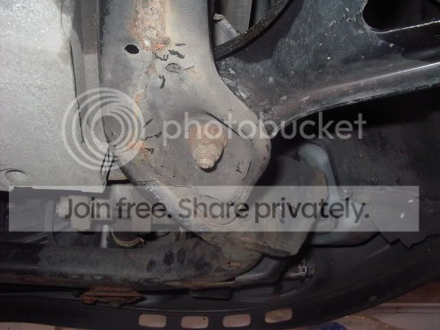

ive had both bottom arms changed this year, one was changed at the place i got the mot done, the drivers side, because thats what it failed on. as most mondeo owners will know you need to drop the subframe to do the passanger side, my passanger side went a couple of of months later, so with that being the awkward side, i took it to rapid fit, being a ford garage i thought they will do it properly, i.e drop the subframe, as it can be done without dropping it, by cutting the bolt off, and putting the new one on with the bolt upside down. well when i got the car back, the steering wheel was a mile out of line, so i took it back, and they tracked it or free, which i thought was good of them. well since they have done it, my tyres worn off real quick, which i thought was strange, as it had 2 brand new bottom arms, the tracking done, my track rod arms are fairly new, so it isnt them, and my tyres are checked regular, and are never over/under inflated. so the tyres waring so quick was a bit funny. at the time i didnt have the money for any tyres so i put the standard wheels on till i had the money for some 17" tyres. well the standard tres wore of in 2 weeks, now this is when i realised there was something wrong, so on further investigation, and to cut a long story short, rapid fit have cut the bolt without dropping the subframe, and put the new one with the bolt the wrong way round, like this
when it should have been done like this
so ive spoke to a freind of a freind who works at a big ford dealers, and he has gone crazy, he said its ford procedure to drop the subframe, and under no circumstances do it the other way, as it can be dangerous, like rapid fit have done it on my car. so ive been onto rapid fit, expalined all of this, and there excuse, they dont have the subframe alignemnet tool, i told him shite, the reason the have done it that way is its a 20 minute job, compared to a 1 hour 20 minutes to do it properly, with dropping the subframe. so they said, bring it down tommorow and leave it with us, and we'll sort it. trust me, after what they have done, it will not be getting left with them, i will be watching every move like a hawk to make sure they do it properly. to say im not happy is an understatement.

i agree fella, ive checked, and everything is tight as it should be , but according to the guy at ford i spoke to, the reason that ford lower the subframe, is that particular side is close to the gearbox, and if the bolt is is fitted incorrectly, it can rub on the gearbox, causing either the bolt to put a hole in the gearbox, or the bolt snapping and the bottom arm failing. he said the chances of this happening are very slim, but it is a possibilty so thats why they play it safe and lower the subframe. now if it was just me in the car, i wouldnt be to bothered, id take my chances, but its the family car and most of the time has my 4 kids in, and there would be murders if anything happened to my kids. ive posted this on a mondeo forum i go on, and a lad on there said national tyres did exactally the same to his, but his tyres went off and the arm was knackered in less than 8k miles, and another lad who fitted his own did it the same way. so obviously its a common way to fit them. but thats why i went to rapid fit to get it done, instead of the place that fitted my other one for the mot, because i thought with rapid fit being ford they would use he correct procedure, but obviously not. if they had said to me, its going to cost more to do it properly, i.e lowering the sub frame, or we can do it on the cheap, and do it the way they have, fair enough, but they didnt, i booked it in, and thought it would have been properly.

If Ford are so adamant that Mondeo arm bolts should go from the top down, why are all Fiesta and escort ones fitted from the bottom up???
I've never fitted them down BUT i do fit a new bolt and locking nut - once in I cut the top of the bolt down so there is plenty of clearance for the gearbox. If you leave it std lenth then it'll touch.
What I gather is when you undo a Mondeo subframe you need alighnment pegs to get it aligned right though.
