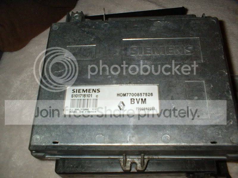

Ok has anyone got pics of a L8 ecu Standard aswell as a chipped one
I smell a rat with a L8 ecu a mate of mine has brought
I will put up pics asap of whot my mate has given me to look over looked @ it the other day very quickly and did'nt notice untill just now that its MADE by SIEMENS In France This does'nt seem to be a L8 ecu for a cossie

The so called L8 ecu for the cossie
Also can someone comfirm is this a Rst fuel ecu ??? My mate was told it was the fuel ecu for the cossie BUT they dont run one or they dont on my L6

I would say the citroen (spelling) symbol on the top one is a give away its not for a cossie
Sure the cossie ones are webber marrelli

Gav thats whot i just spotted when i got it out of its Plastic sleeve to have a proper look @ it I think someones in for a f&*king good kicking

As for the other one mate, it does look like a rsturbo one but i don't remember mine having the jetronic bit at the bottom but i may be wrong

No way is that a L8
I hope he gets his money back

It's a renault ecu, look at the first picture, you can see the renault diamond shape
where did he buy it?

series2 erst bosh jetronic ke ecu part number is :-0 280 800 194

yep defo series 2 fuel ecu,and defo NOT a L8

E.C.U. Ref : S 101 715 101
Chip Ref :
Ori C/Sum (8bit) : 6B79
Ori Chip Type : 27C256 dil
Std Bhp :
E.C.U. Brand : Siemens
E.C.U. Type : Bendix / Fenix 3
Serial Option : N
Flash Sys :
Mod Chip Type : 27C256 dil
Mod C/Sum :
Key Type : 28pin-key1010A dil
Renault 1.8 16v.
Thats Usefull to you eh?
2nd Box is a S2 RST fuel control unit.

hmm renault 19 16valve by any chance stu?

Indeed Sir.
