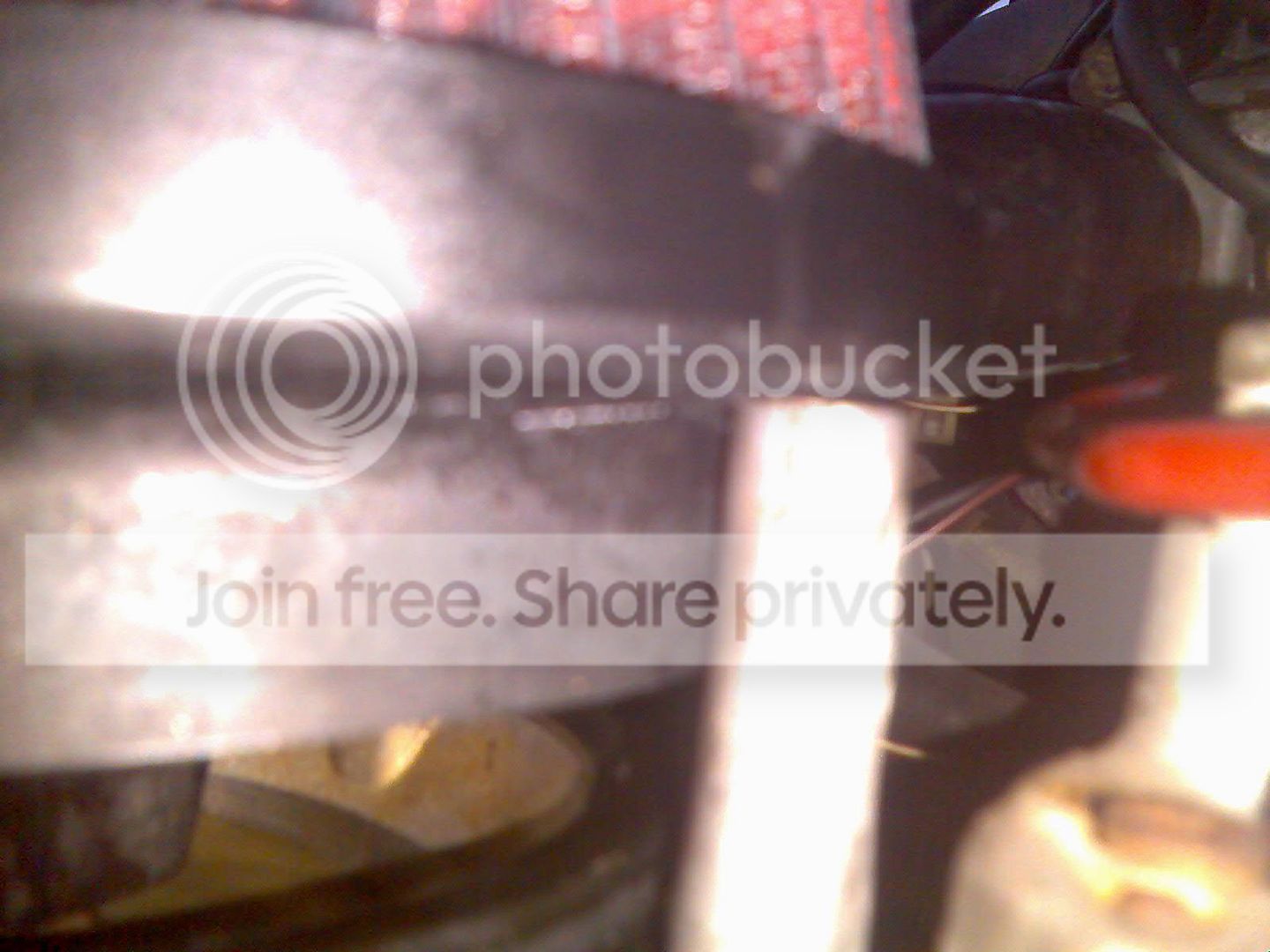

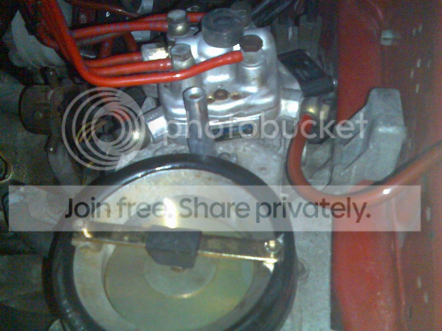

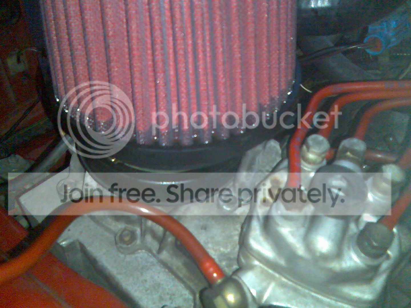

hello
another stupid ass question but here go's ...see the co screw thats beside the airfilter , mine sits up about 2inches from the metering unit .is this normal its just that when i go to fit my new induction kit i cant cos the shaft that holds the co screw is in the way and means i cant get the filter onto the unit...i know this probley sounds crazy shit but its really baffled me
heres a few pictures :
cheers
rab

Ok, you have the later and more user friendly metering head, however you choice of filter is going to make life difficult, ive got a K&N and i can just squeeze it in and it pushes the lip over ever so slightly, you filter is a lot larger than mine however.
You could remove the post and block the hole with a screw if you are very keen on having that filter..........
