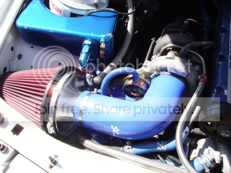

Got my new K&N filter on... cant believe how much of a tight fit it is! Im gona have to change my aeroquip fittings on my Goode tank!
Looks the part thou!
Also to all Grahame Goode hose's owners, they've change the colour to samco blue, you cant get the light blue anymore!

mines like damos,i dont like the oil fumes getting sucked back into the turbo,all the insides of the cooler and turbo end up getting covered in oily deposits you wont get a tighter aeroquip elbow than the one you already have,i had same prob ,so blanked it off and had a boss welded on the back of the tank and ran it there

I was thinking of taking the washer out and then try cutting down the threaded section of the fixing...
The fitment isnt a massive problem just means the filter will get bashed around a bit, at Ł70 ish its not the end of the world.

you could cut down the nut but that would be no use without cutting down the male boss,which you cant do as it has a tapered seating,so it wouldnt seal

I think, I'l just have to live with it for the time being...

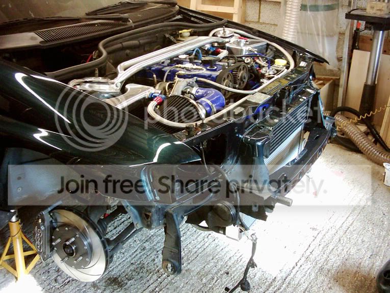

This is mine, (sorry its the best pic ive got ATM) its got a 45deg fitting on there which gives a little clearance
I have also placed a small peice of rubber in between the slam pannel and the filter as it was slicing through the rubber at the Fat end of the filter.

Stunning mate... is that one of Mike's Cam Covers...?
