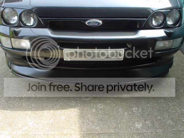

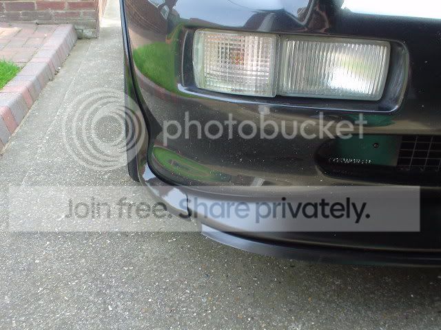

Old Apr 21, 2006 | 02:15 PM
ian rst's Avatar
ian rst
Posts: 754
Ok well i used a normal grey primer (i think) and satin matt black spray with some laquer just for protection. The hockey sticks i didnt do a mate took them off me and did them for us which is why they are slightly different but i think it works quite well, they started as carbon fibre ones which looked crap as they were damaged.

Ian - did you use spray cans? - if so that is one hell of a good job!
& thanks for the input and pics guys!
