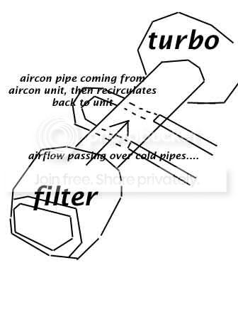

rick,...thinking some sort of aircon unit, sent through the air filter pipe, but will the pipe going through the air filter pipe disturb the air flow too much and fook it up some how,..???

No - the pipe isn't the problem. How are u going to drive the aircon unit

or instead of just a straight pipe going through filter pipe, it could be coiled,....

why not just get a better intercooler?

Aircon uses power, as much as you'll gain

Air con evap would freeze up as you need a calculated continuous air flow to match the cooling load..
cause the colder the air, the more that can be compressed in a certain space,....
so theres no point the way i was thinking then,...
but its still worthwhile if dont right????

Surely the hassle of plumbing in a pre-turbo air cooler wouldnt justify the benefits gained from running it??
Old Apr 17, 2006 | 11:06 PM
Gregs's Avatar
Gregs
Joined: Dec 2004
Posts: 787
From: Derby
Originally Posted by Itsmeagain
Look, just trust me, it bloody works
If pre-compressor water injection didnt work we'd all be speaking german as wedve prob lost WW2
does it work better than inj in to charge air?
Old Apr 17, 2006 | 11:10 PM
Stavros's Avatar
Stavros
DEYTUKURJERBS
Posts: 29,378
From: North Korea
At dropping charge temps, yes, purely as its got the most time to do it before the engine.
At lowering in cyl temps, no, as you want that as close to the engine as poss.
Thats why serious cars run pre compressor as well as dirst port w.i.
Old Apr 17, 2006 | 11:30 PM
Carlsworth's Avatar
Carlsworth
Former Sponsor
Posts: 4,334
From: blackpool
hassle of rigging up a zanussi fridge freezer to the airbox
brilliant
what about then,.....
rigging a small engined car injector in the airfilter pipe, and wiring that to feed off a normal injector so when it pulses, it injects said pipe,....
