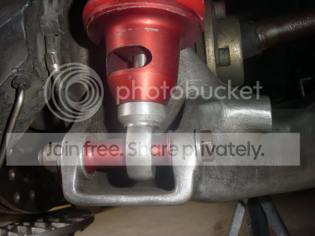

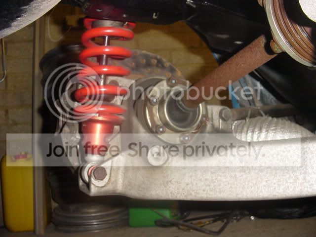

Not a great shot and not particularly bling coz everything is waxoyled and practical
you can see the avo's and I've had the rear brake hoses extended in flexible rather than have a solid piece on the arm.
Still haven't managed to make it understeer through roundabouts yet though

Kev, they're very good. I've been playing around with the damper settings, although last night on 10 clicks on the rear and full soft on the front it felt like i had egg shaped wheels Five Clicks on the rear and full soft felt good this morning. Haven't wound them up full hard yet. Having MO's really helps as you just put your hand through the spokes and twiddle the dial, oooerrrr!
They don't crash around either which is what i was expecting. SPring rates are 375 on front and 170 on rear.
So far can't fault them

paul,
get some copper grease or something ALL over the threads on the shocks
trust me, learn by my mistake

paul,did you have any problems with shock body rubbing against car body?
Old Jul 28, 2004 | 11:24 AM
Spiky's Avatar
Spiky
Posts: 26,931
From: Cardiff
passenger rear on all cossies rubs with coilovers

Not sure on the exact science Steve, but I think its due to allowing the wheel to move in a more vertical axis rather than the usual tramp/arc which reduces the contact area of the tyre. I'm sure somone will have a better explaination involving bump steer etc
Yes, passenger side has been tickled but i think i need to do the same on the drivers side to hammer time

spiky, i dont think all coilovers rub, just avo's! not too sure tho.
Old Jul 28, 2004 | 01:06 PM
Paul Eggleton's Avatar
Paul Eggleton
Posts: 5,749
From: Saving the planet
Its the spring that rubs, so I think if you have coilovers with 2.5" springs they will probably rub.
