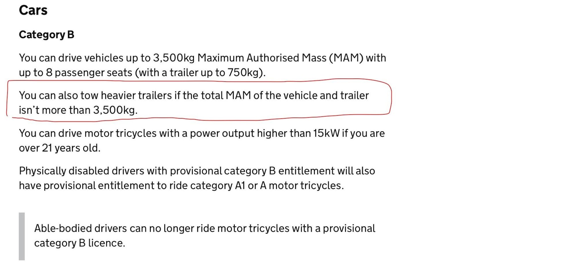

Basically what I'm getting at is I'm trying to find out if there is any way legally I can transport an untaxed un-mot'd vehicle myself and everything is pointing to "NO"
If you pass your test after 1997 you can tow a trail or above 750kg as long as the combined gross kerb weight of car and trailer don't exceed 3500kg, I don't think even this applies if passed in the last couple of years

this is correct. I tow under these rules above myself and I passed my test in 2006
Re category B with licence after 1997.
You won't find a normal Car / Trailer /Loaded vehicle combination that will comply with the 3500kg rule.
The trailer and loaded vehicle can't weigh more than the tow car.
So the moment you put a normal car on a trailer you're overweight for the licence class.
You may just get in with a stripped out track car on a lightweight trailer.
Most cars aren't rated for towing a car of the same weight let alone a trailer as well.
You need to be in a 4x4 to get a good towing weight, then you've little weight capacity left.
From https://www.gov.uk/old-driving-licence-categories
Licences issued between January 1997 and 14 October 2012
B. Vehicles up to 3,500kg Maximum Authorised Mass (MAM) and up to 8 passenger seats with trailer up to 750kg; trailers over 750kg if combined weight of vehicle and trailer isn’t over 3,500kg and the fully-loaded trailer doesn’t weigh more than the unladen vehicle
You'll only get small / medium cars to come in under weight.
Thanks a lot for all your replies people!
So basically I am looking for a trailer car combo of under 3500kg or a recovery vehicle with a car on the back of under 3500kg which is pretty much not gonna happen really is it?!
Soon as I put a normal car such as mk4 escort on the back I'm over weight and you can just guarantee my luck that VOSA will be at the next motorway junction
So basically the only way I am going to be able to transport un roadworthy cars long term is to pass my B+E test and get a trailer with winch.
