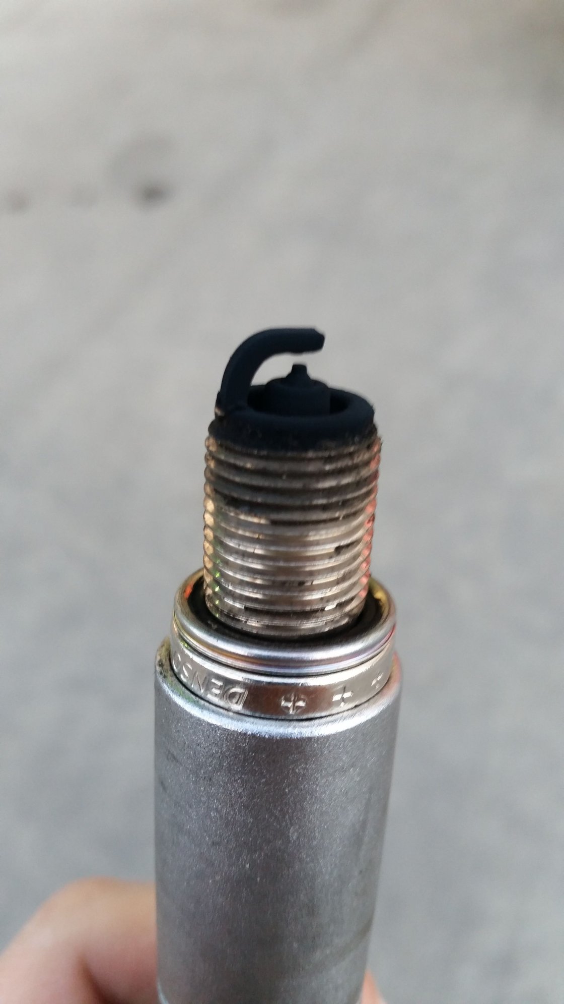

I forgot to mention there is often smell of unnbured fuel when the car is without the chip,but it seems to run normal tho. I tryed the chip again and its running very rich!
Could the problem be the ECT or HEGO?
