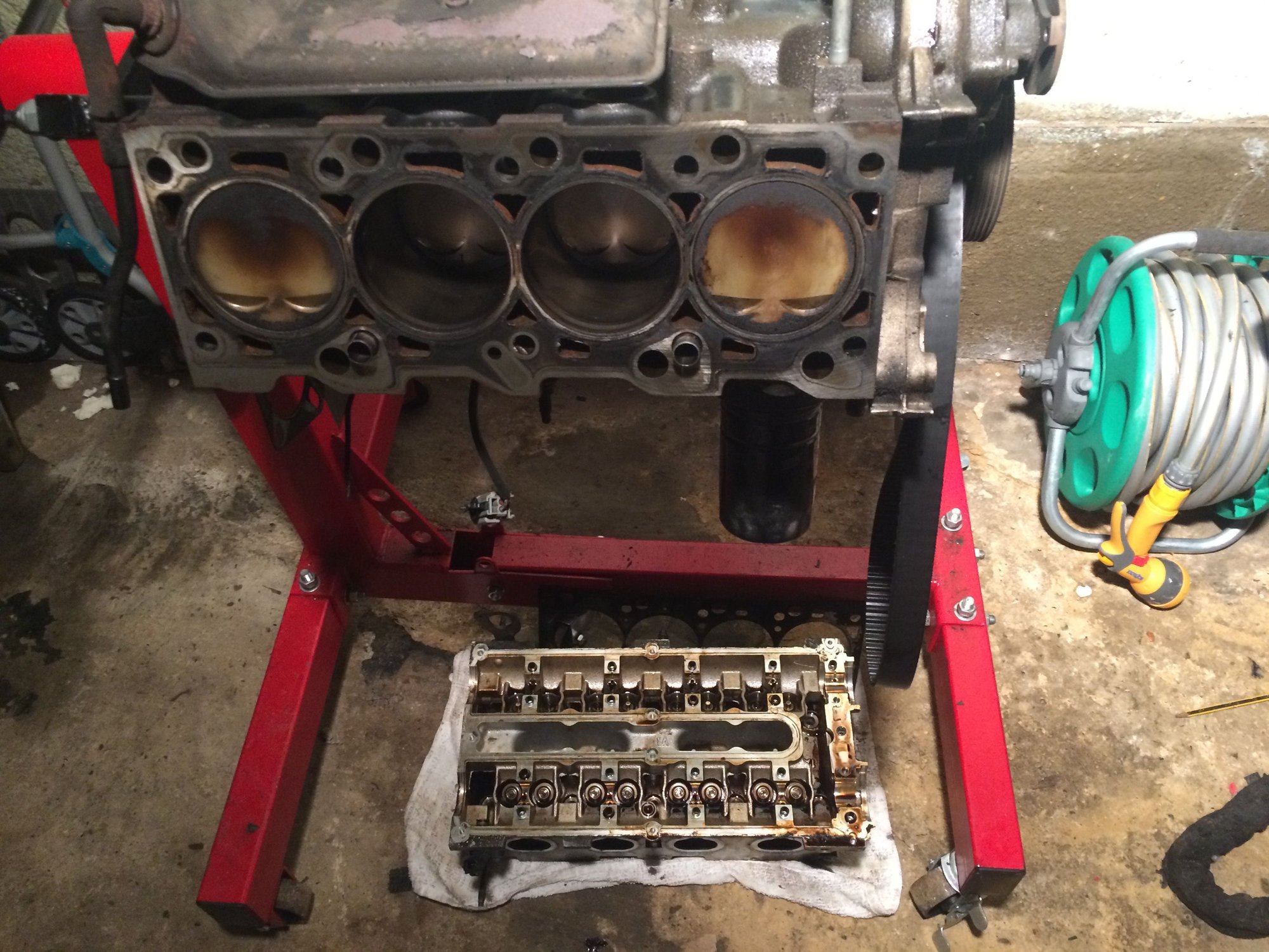

Cylinder head is off..
All ready to be sent off for some magic treatment.
Cylinder head is going To be ported/gas flowed
Competition kent cams
Larger valves if possible
Piper cams vernier pulleys with VVT delete kit (retro-ford)
Head skim
