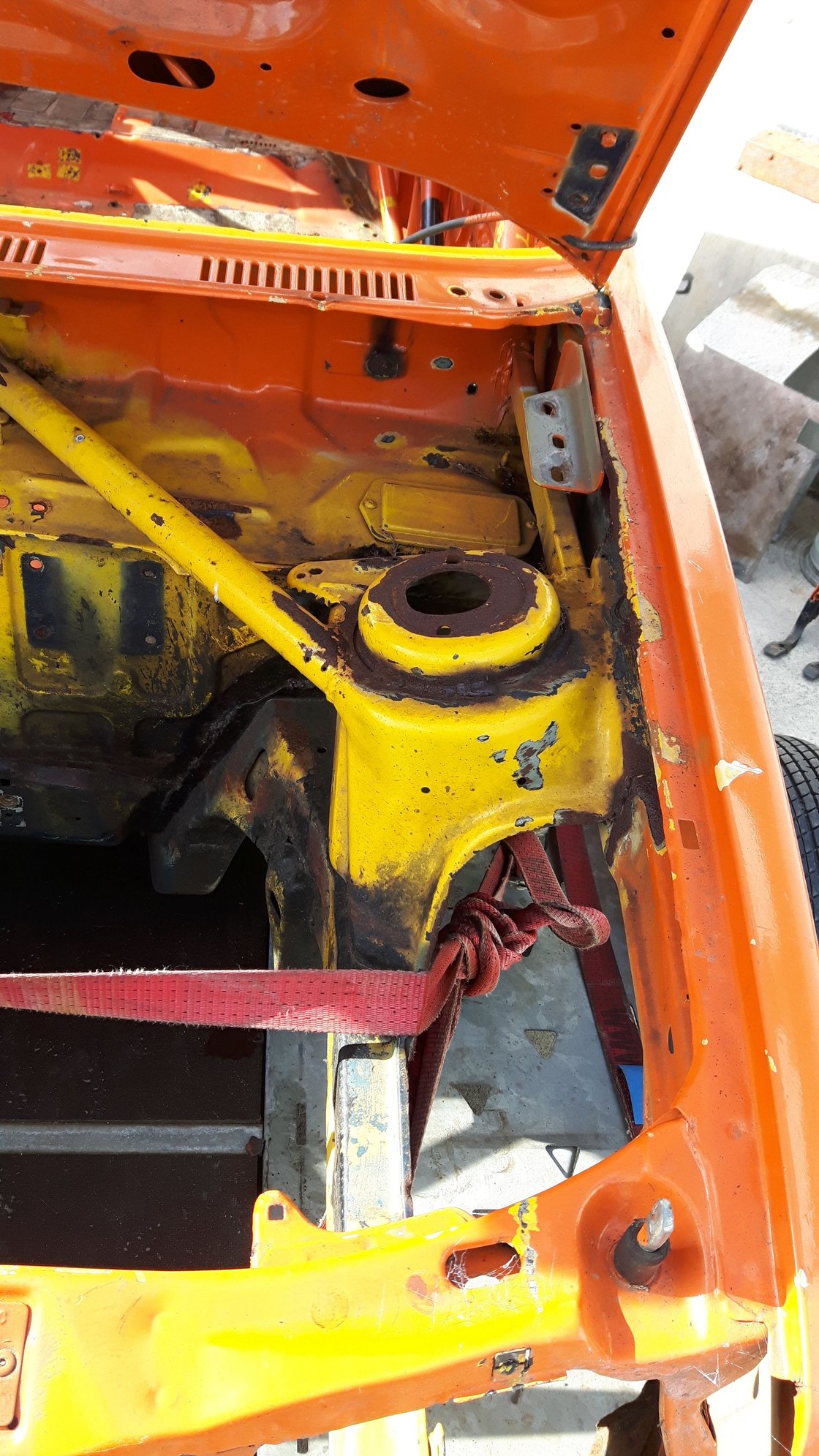

Hi everyone , This build thread will be of my Mk3 Fiesta witch will be running a 1.6 cvh engine. The plan is to restore / repaint and build it up for Sprints & Hillclimbs over here in Northern Ireland. I bought a shell project with engine and some parts, the rest is up to me to gather up as it progresses . So far I have stripped the rest of the shell out and it's off to the blasters to have the engine bay and floor blasted as it was stripped and left outside long before I bought it. This is how it arrived .

Some parts look a bit scrappy in round the floor & engine bay but it's just where the last owner was stitch welding and it was just left like that with no primer = rusty
