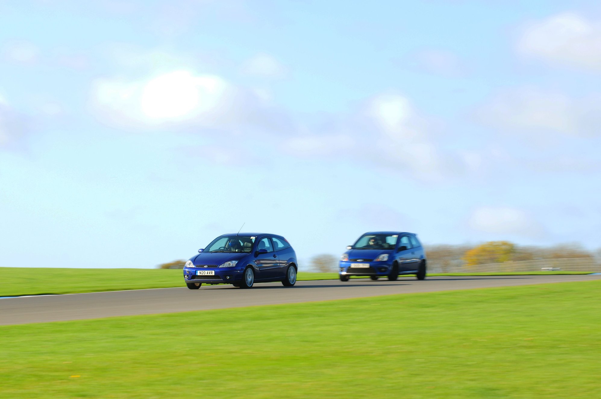

Not much has happened with the car lately, but yesterday I took it to Donington for a run around the GP circuit. Massive fun, the car did well, and the circuit is great fun. Some really interesting cars going a lot faster, but also overtaking the odd car too that a Focus has no right keeping up with
Some photos and video:

Looks like you had fun
ST170
Was a great day. I guess the clutch and brakes need looking at, but in normal driving conditions everything is fine, so it might want some slightly hotter pads for track use, and the car ticked over to 70k on the way home so I assume it's the original clutch and is due a replacement anyway!
I'm half tempted to get the single mass flywheel from the states, but I'm not sure if it'll be too abrasive for daily use.
