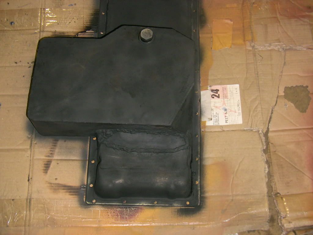

thought id post my project in here. putting a 3.6 td marine vm engine in my e30. used gearbox from bmw custom fit to vm bellhousing. converted from auto to manual box. car and engine i had anyway. proper budget build spent £100 so far on machining and a manual fuel pressure reg.
fitted bmw flywheel where torque converter was.
fitted getrag box to original vm bellhousing with adapter plates.
had to move sump pan as it fouled on crossmember.
engine mounts for new engine below.
relocated pick up pipe for altered sump.

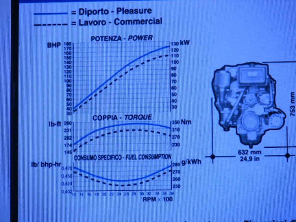

vm motori there engine building company in italy. they used to build boat engines, the hr 692 ht was the start of there higher revving engines for commercial use in trucks and cars.
the 4 cylinder version the 492 ht was fitted in the rover sd1s and some early range rovers.
