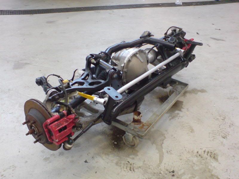

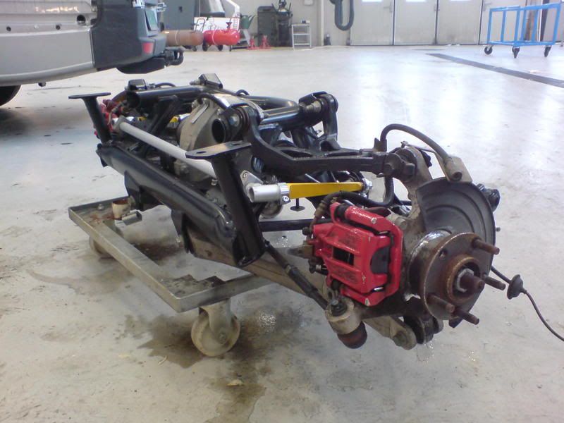

A few old pics...
Here's the rear suspension , almost finished, quite a few mods on this one as well,comming from a 2004 mustang Cobra R, the "beam" now features solid mounts to the new rear frame of the car with no bushing,driveshafts are modded ones, bladed anti roll bars, made it ready for the adjustable tracktion controll system and there's also a steel brace around the rear housing of the 8.8" plated diff now, but... I made some more quite major mods to suspension when I found out I had extra time due to other parts missing...think you might gonna see that in PFM next month??

Send a message via MSN to miller3
Joel where did you get the rear beam from mate
Ebay
