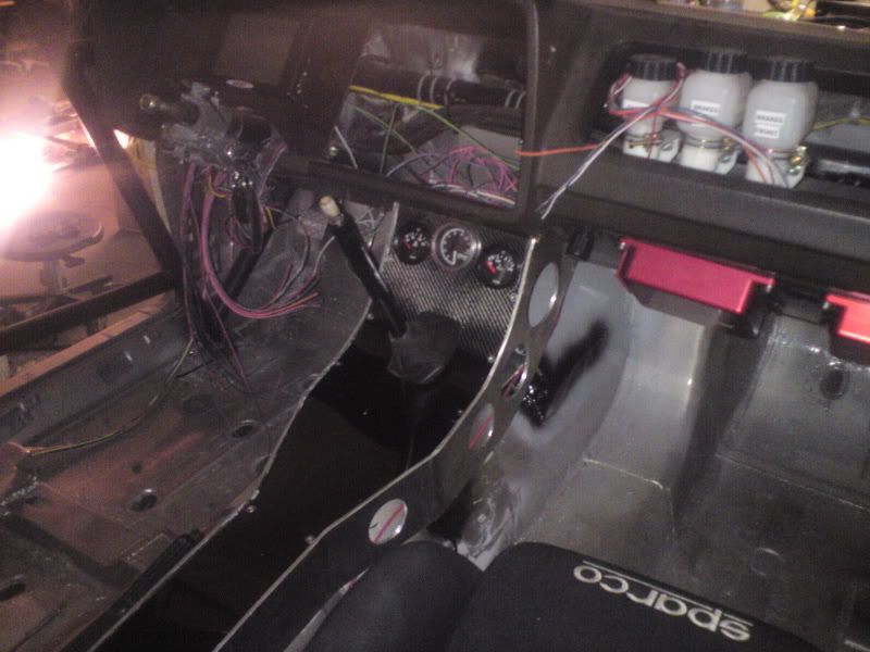

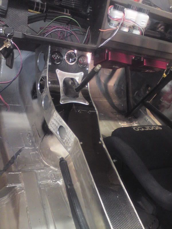

Well well, we are STRESSED theese days, my camera is destroyed so that is the reason for no new pictures, will have a fotographer visiting us soon with a decent camera so we'll get som real pictures for you!
The painter visited us yesterday, we are aiming delivering the car for the respray the 2nd week in may...shit we are in a hurry!!
Other than that, even more wiring is complete, the last section of exhaust that was left, from the turbos to the downpipes at the firewall is finished on the left hand side and the parts for right hand side is made ready for welding.
As soon as we get the dynamat sheets from the us, the interior mats and interior trim will be fitted again.
We are doing what we can to bring the car to DHB in denmark 4-6th of june, altough most likely, not race ready, but we will be there, and we're gonna have some fun
Ahh, I got two pictures of the almost completed centre console - what do you think?

tis looking very good, although the handbrake looks a tad close to the seat
what axle setup did you have with the YB lump in there tho Joel? looks to be lowered at the back end, but without the camber issues
any chance you will start up a line of those bottom arms for the mk2 granada and tvr owners?
It is okay, you'll se it at a later stage
I did use the std trailing arms but made shims that ui put between the trailing arms and the wheel bearing carrier, worked just fine it took away most of the camber issues.
As I am not running any company nor has unlimited access to machining facilities I will not be making any kind of parts for others I'm afraid, but thanks for asking
Cheers
Joel
