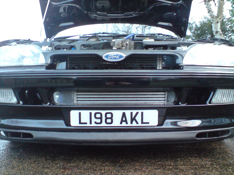

got 2 say mate this looks hard as nailes realy like it hows the new engine

lets hope it gets set up on friday full boost baby

All booked up for a setup this friday at Grove Garage
Then off to the RR day at TOTD the day after

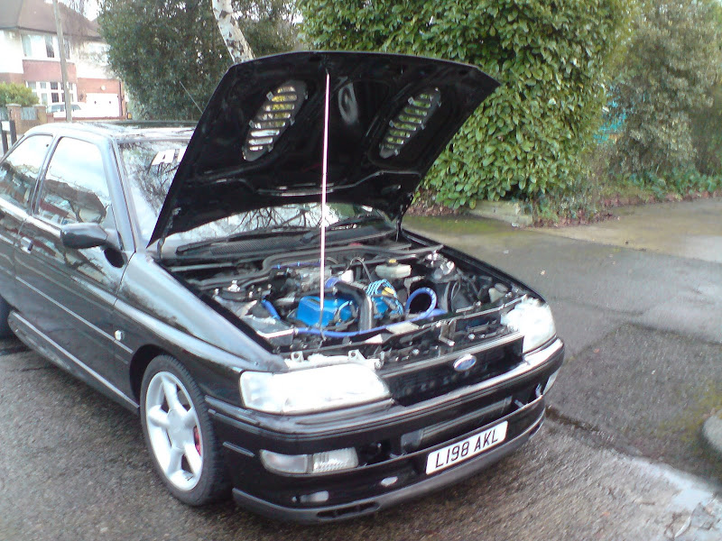

lovely lovely car......very nicely done
any reason for the chrome number plate surround? other than that it looks awesome, and having been in alex's old cabrio, bet it goes well too

Chrome number plate surround has gone now
Also
After my setup by grove and RRDay at TOTD my car was taken off the road the following day for a slight change in spec.
The car made 225bhp at 4k but was stopped as it was running out of fuel.
Well as my green IW-31 injectors where maxed out I have change to a set of IW-058. Also when doing that I have upgraded to a T34 .63 and a 3bar map sensor.
All booked up for a Map/setup this Saturday down grove
Pics to come soon.

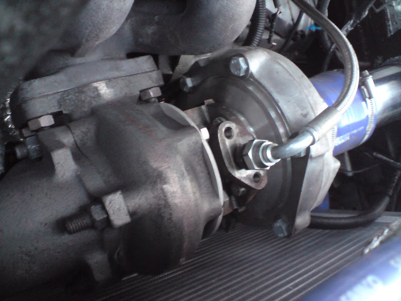

Update soon. With new Wheels fitted (ET35 Now) and this in the engine bay,

nice one what spec?

Love your car Ollie...always looks so nice everytime i see it..credit to ya
looking forward to seeing it when its faster

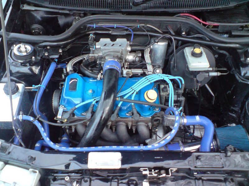

Below is the Blacktop Zetec Turbo fitted! Speced up for 400bhp Also just fitted my new airfilter.
I have a new Xover pipe going to auto specialists soon for a polish up
Ollie MK5 Turbo is offline   Reply With Quote

looks awsome , what bottom arms are you using on that? i am having a night mare with mine eating bottom arms at the moment since i had the turbo fitted

I am running the Area Six lower arms with camber adjustment and Spherical Bearings. One of the best things i have done to the car. Well worth the money.

Originally Posted by frayz View Post
Looks great,
Looking forward to the updates. What turbo is on it and what boost do you intend on running on it mate?
Its a T34 .63 It was running 22 PSI on my old Ze-vh turbo so a bit more on this spec. 25+ all down to what grove garage find safe.

Should be a seriously quick car on that sort of boost mate. 350ish on the 34 should be made without trouble.
Awesome
