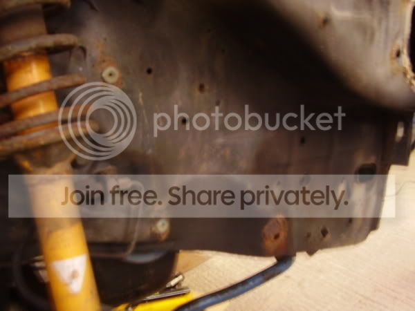

wheel arch has been cut out ready for new one
welded in place
now with filler
wing now welded in place
the rear panel had some rot here so i cut it out with the grinder
and re plated it
top bit of rear panel had a hole in it

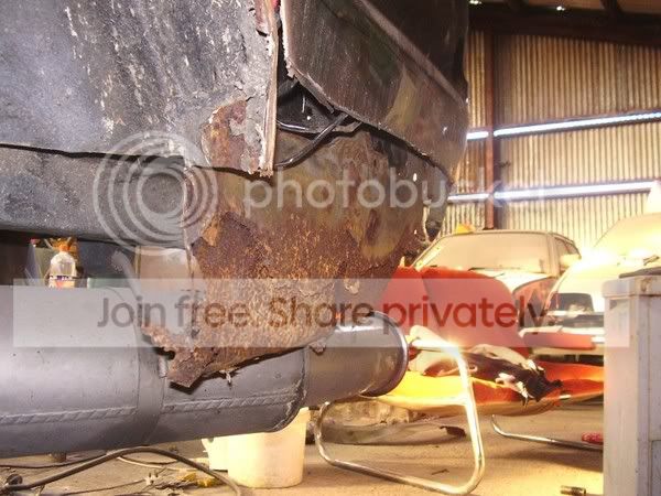

more pics for you to look at
this was so rotton i couldnt beleave my eyes when it fell off
the part that fell off
wheel arch cut out ready for new one
new inner sill welded in place
that panel hanging down is 2.5mm thick so this shouldnt rot
for at leaset years , once the sill is welded on to it
all i have to do is cut it level with the sill

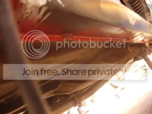

new sill ready to go on
now welded in place
some pics of it filled and ready for primmer
underside of sill
