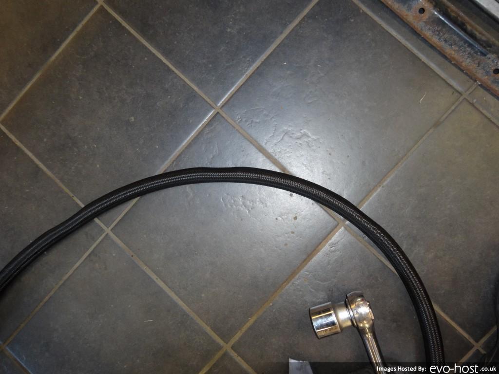

Here is an extreme example of some -16 Torques black overbraid nitrile rubber hose hose bought for a dry sump system. This was at 2m in to a 5m length. So almost in the middle. The hose ended up having to be joined ( and no the buyer didnt bother contacting torques as time was against us and we needed to get the car running asap, so returning the hose to them and waiting on new hose simply wasnt an option )
So...no big deal ? hose maybe got a bump or two in transit ( well packaged so not likely ). Either way, they clearly sent it out in this condition.

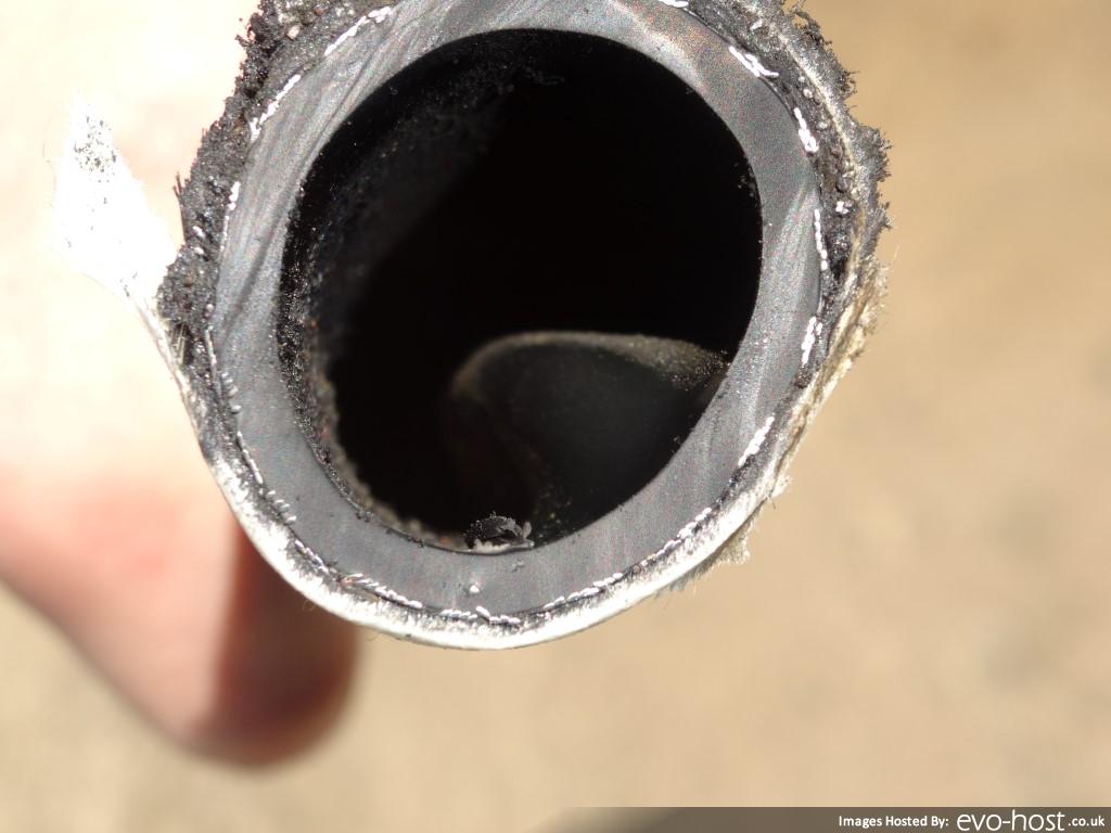

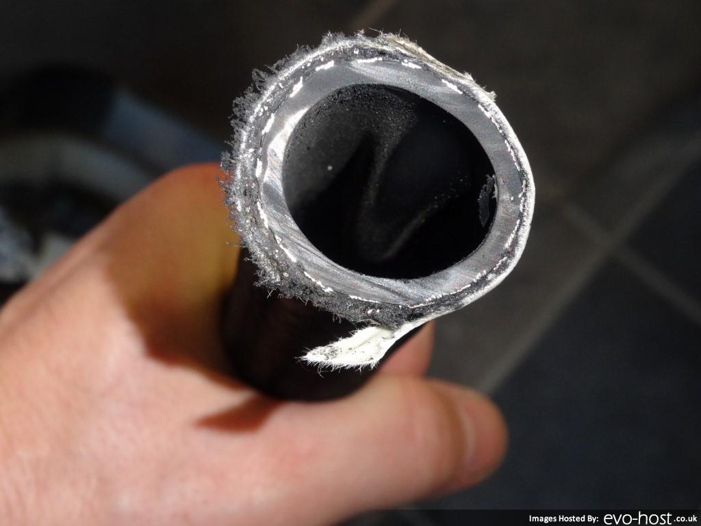

So what's the problem ? Well...lets cut open the hose at one of those sections. The internal rubber heavily deformed and easily blocking 50% of the hose itself. This is not physical damage, this is definitely shoddy manufacture. And this was in 3 sections of the hose ! not just one.
