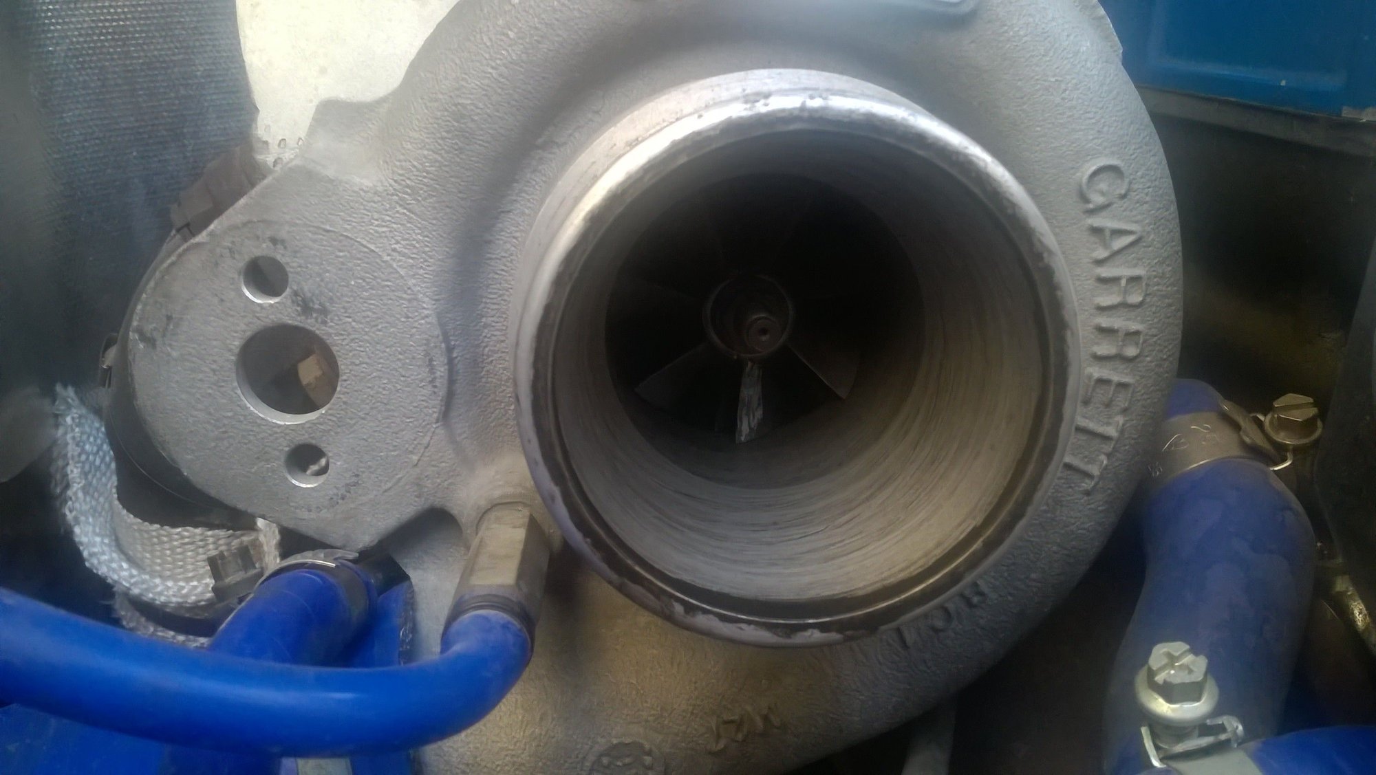

I took some pictures of my turbo and now I believe that my turbo needs a rebuild what is your opinion
