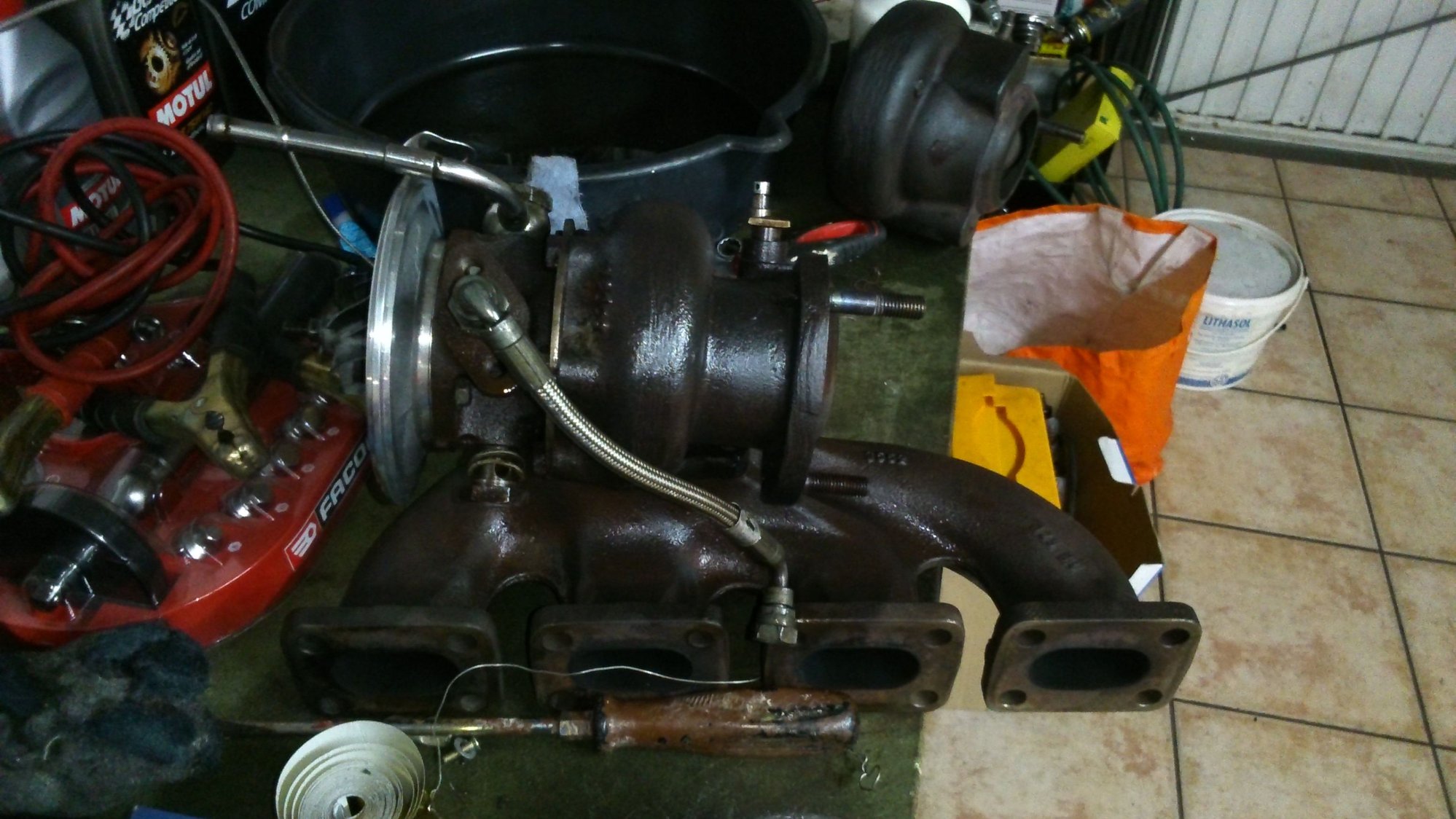

Hello everyone,
I live in Paris and I own a sierra cosworth 4x4 Engine full stock
I intend to set up a R GT3071 with an exhaust housing cosworth AR72. I chose this model because it retains the original exhaust line and the internal wastegate.
Have you ever ride this turbo? Loading later? Since that is on dual ball bearing but it is not a ar63

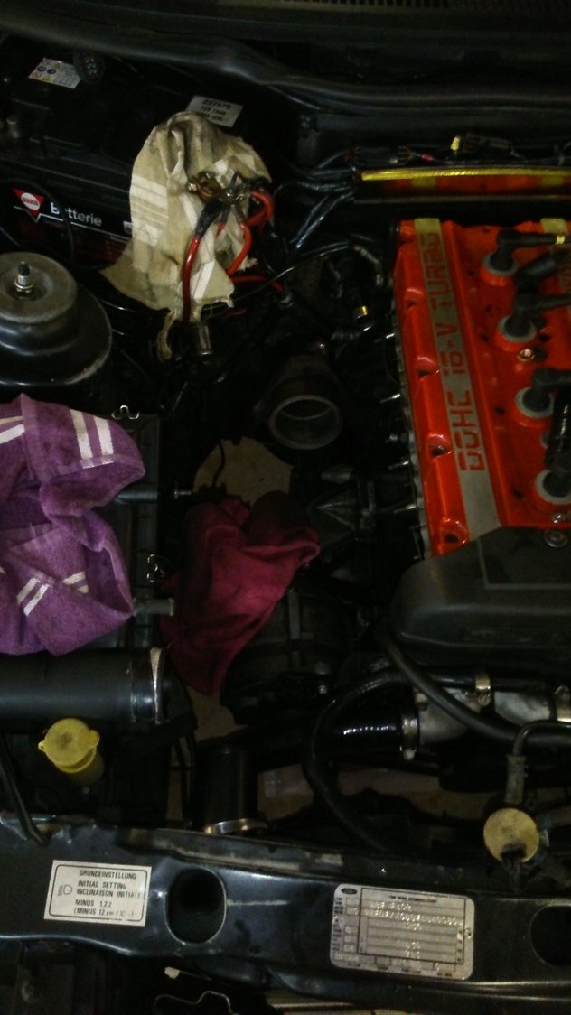

Good morning Marc,
At the moment I am in full assembly of the turbo compressor. The most difficult has adapted this turbo is the oil return.
It touches the mounting studs of the flange of the manifold.

It has a.63 housing. I ported this otherwise you have boost creep.
Turbo is fitted to 2wd manifold with spacer.
Ecu is a KMS MD35.
